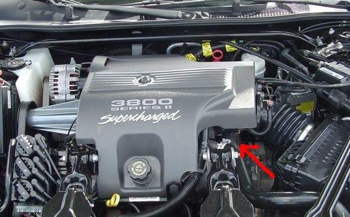

Umm I have one more question about the TPS on my 1997 Regal GS. We (the one working on it mainly) need to know where the thing is located so we (I'm supervising) change it. Thanks in advance for the help!

Just remove the plastic engine cover and it will be the sensor where the red arrow points to. There should be 2 T20 torx screws that hold it onto the throttle body.

Thank you again bnaylor. We had no problems finding it and I even helped changed it.
