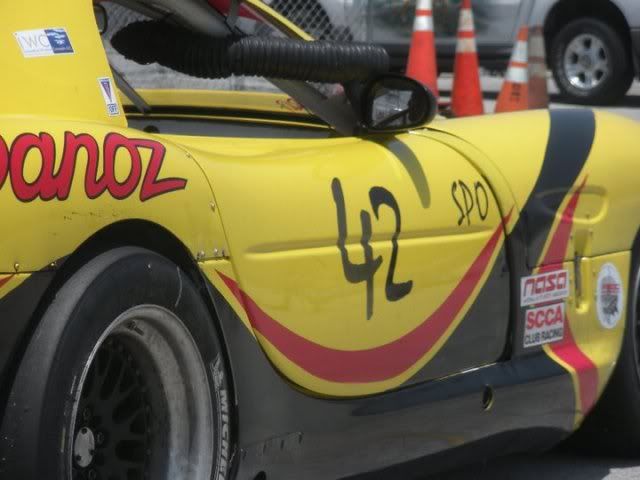

Both front tires tuck inside the fender when compressing (Drivers front has about 2" between tire and plastic fender edge and passenger front has about 1" clearance). The rear tires (drivers rear about 2.25" and passenger rear has about 3") when resting. I just added custom fender flares all around which make things less accurate. You should get a set they look sweet.
I found some old pics of the fenders.....I'll post some new ones with the sweet new fender flares.

OK...still have some fitment to do with the plastic gasket/trim but they are basically installed. To remove the hood you undo a screw (like the hood screws) and the flares go with the hood. I have not raced with them yet but soon enough..... These are easily reproduced and the fit was pretty good. I might not paint them...cant decide
