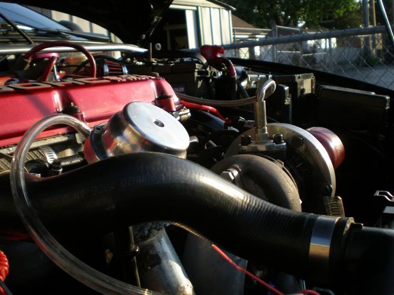

Dude I had it running around toward the belts, then around to the radiator and along the top until it came back to the compressor. That was far out of the way I thought. The temp I made when coming back home had to go right over the mani because I had no other choice.

http://i59.photobucket.com/albums/g291/david-b/turbo/P6230258Medium.jpg
Here you can see how I ran it going over the radiator pipe and then wrapped all the way back around.

Um, what kind of line is that??? Looks kinda, ...not hardcore.

Bought it from Menards. Can't find better hose anywhere.

I dont see why you keep melting them. I've never had that problem with mine. The line im using is rubber coolant hose I think. Its rubber with some kind of thread stuff in the middle for reinforcement.

Update:
Second cooling fan went in no problem. So I now have a 10" slimline fan and a 12" slimline fan. They're both wired to turn on together. Didn't install a manual switch, but we'll see how this goes first. When the fans are on, you can feel air moving around the entire bay, not just infront of the one when it was just the 10". So that's definitely a plus.
Also got that new radiator cap on (yes it fit) and refilled with coolant. No leaks.
I think next... I'll try to figure out where I'm leaking oil from.
