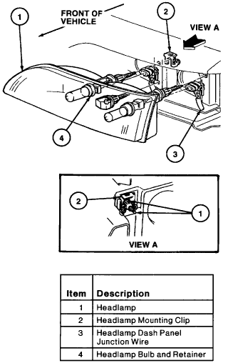

There should be 3 clips holding it in place. Here is partial directions from Alldatapro.
Remove three headlamp mounting clips retaining headlamp to radiator grille opening panel reinforcement. NOTE: Use snap-ring pliers to spread headlamp mounting clips, then pull straight upward to disengage.
Remove headlamp from vehicle.

Thank you. wish I had a picture of the clips

Wish I had a better picture for you.

Thank you. I do see those. I did not know if those were also holding the lens in. I thought they were to adjust the head light, and were not to be removed.
