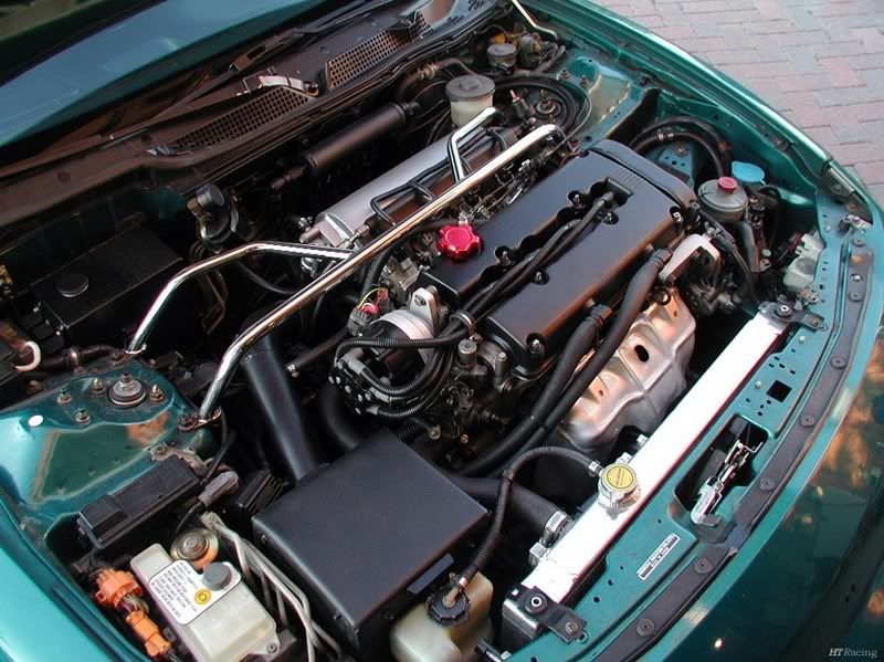

Classicrocjunkie
04-08-2007, 11:14 PM
http://img87.imageshack.us/img87/7486/dscf0788rm0.jpg
Mines quite dirty actually..... :(
So was our shops turbo'd 2200
http://img151.imageshack.us/img151/329/47bx.jpg
... I guess we best jump on cleaning these things. ;)

Schister66
04-10-2007, 10:58 AM
those engine bays look soo much different than what i'm used to....they are clean, but here's what i want my engine bay to look like...not that its ever goinig to happen, but still this is clean as hell!!
The car belongs to Tony the Tiger. It is a wicked street car that makes around 400whp, but has crazy response. The engine is a built DART block w/ 11.5:1 compression, a GT2871R .82ar turbo and ITBs enclosed within a hand built plenum. Tuned on AEM by Tony himself. The car also has water injection to help with the possible detonation problems....the best part is how sleeper it is...
http://i33.photobucket.com/albums/d61/Schister66-2/TonyTheTiger--sleeper.jpg
