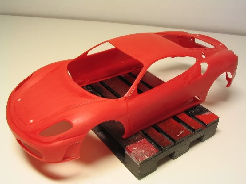

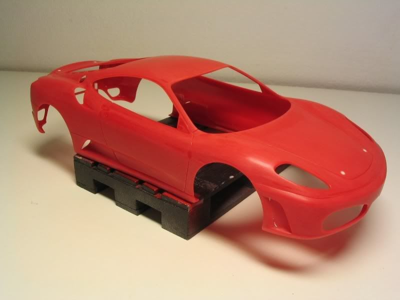

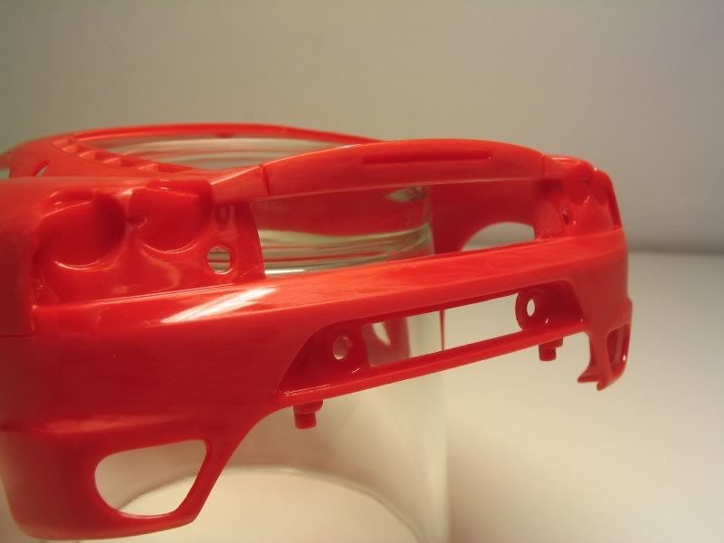

Tiny update: the last portion to be removed from the body was the area between the exhausts on the rear bumper; proceeding as usual drilling the contour and then removing the part with a mill and finishing the cut with files and sandpaper
http://i11.photobucket.com/albums/a163/RJ1108/F430%20Challenge/430ch124.jpg
All the panel lines have been re-scribed with a SRC blade because all the lines from the kit are somewhat on the soft side
http://i11.photobucket.com/albums/a163/RJ1108/F430%20Challenge/430ch125.jpg
I also cured the air outlets on the front bumper, tedious work, carried out with files, mill and shaped sandpaper
http://i11.photobucket.com/albums/a163/RJ1108/F430%20Challenge/430ch126.jpg
Then I sanded all the body with #1000 grit under water, I also carefully cleaned the panel lines with a toothbrush to better remove dust and residual. I let the body naturally dry overnight
http://i11.photobucket.com/albums/a163/RJ1108/F430%20Challenge/430ch127.jpg

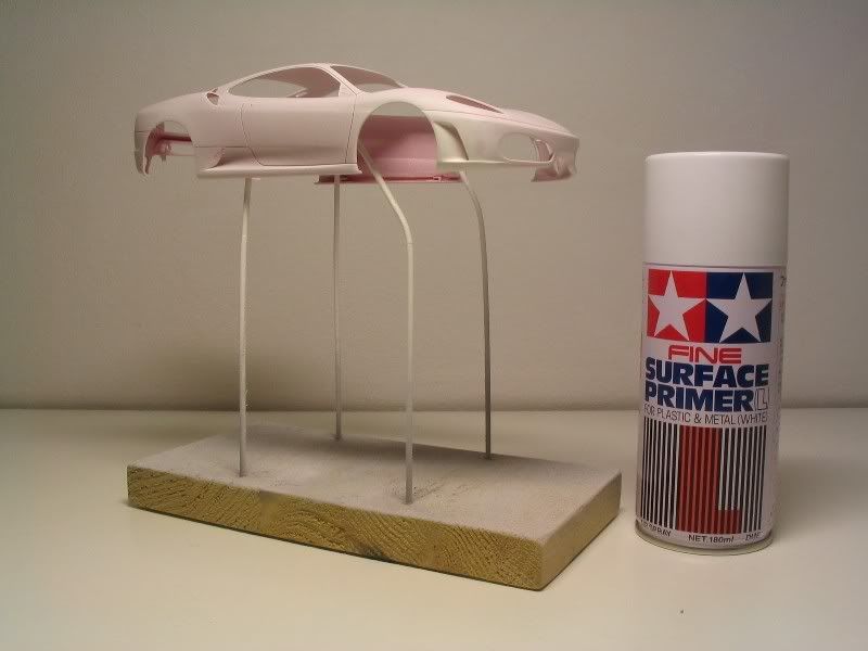

I installed the body on my own made paint stand
http://i11.photobucket.com/albums/a163/RJ1108/F430%20Challenge/B4.jpg
…and sprayed it with alchyd matt white. Under suggestion of my friend Alessandro, this time I did not use the acrylic sealer before the primer: he discovered that the poor quality of the kit plastic badly reacts with the sealer, revealing the sanded areas and damaging the body surface. So, once primed, I’ll wait several weeks before proceeding with the color. At a first check, some panel lines look correct

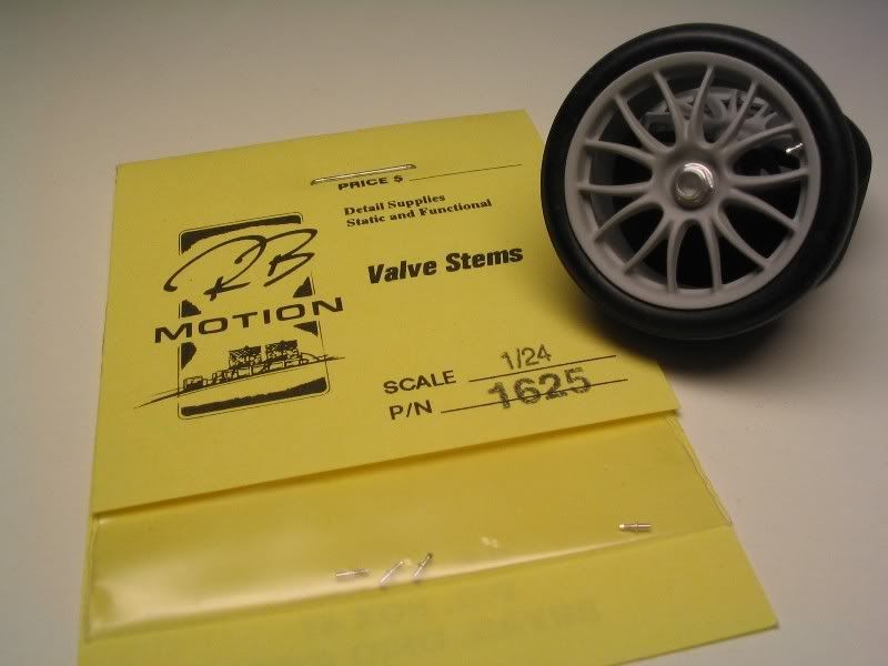

On the wheels, RB Motion’s valve stems will be installed
http://i11.photobucket.com/albums/a163/RJ1108/F430%20Challenge/430ch133.jpg

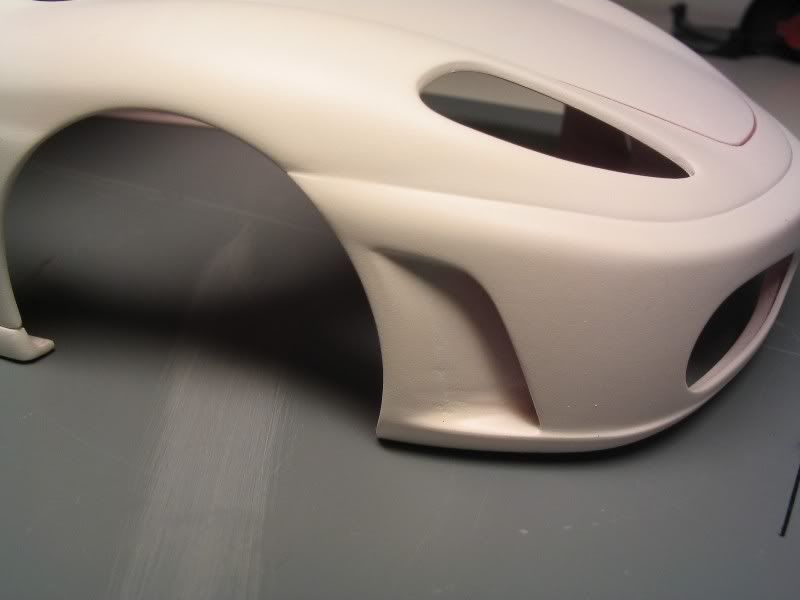

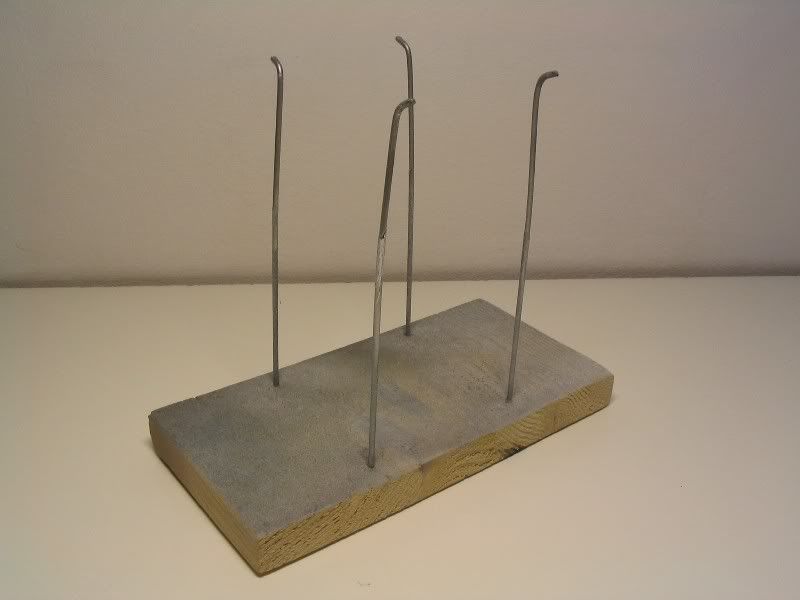

So …stripping time. Reading the recent topic about stripping paints, I came to the conclusion to try pure alcohol. I put the body in for a few hours and then I tried to brush away the paint, at the beginning with a soft brush and then with a hard one. No chance at all
http://i11.photobucket.com/albums/a163/RJ1108/F430%20Challenge/430ch141.jpg
In the mentioned topic, someone wrote that the brake fluid could affect the latest poor quality plastic present in several kits, and the F430 is included in this list. So, to avoid further troubles, I started a sanding session - #1000 grit - which took approx 1 hour
http://i11.photobucket.com/albums/a163/RJ1108/F430%20Challenge/430ch142.jpg
http://i11.photobucket.com/albums/a163/RJ1108/F430%20Challenge/430ch143.jpg
and this is the result
http://i11.photobucket.com/albums/a163/RJ1108/F430%20Challenge/430ch144.jpg
http://i11.photobucket.com/albums/a163/RJ1108/F430%20Challenge/430ch145.jpg
Now, I’ll re-start priming the body work with Tamiya white primer. Hoping this will be the word END on the priming process.
Bye: Robi :)

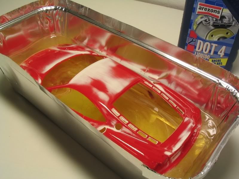

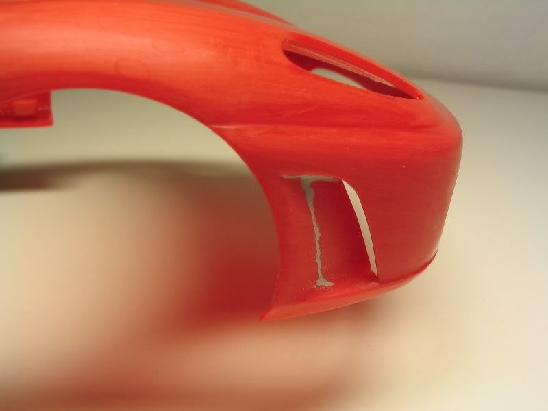

Okay, I was too nervous to wait. I took two bottle of DOT4 brake fluid and put in the F430
http://i11.photobucket.com/albums/a163/RJ1108/F430%20Challenge/212_1234.jpg
In less than six minutes the bodywork was cleaned. I washed it quicky but energically with alcohol to remove fluid residuals and immediately after I washed it carefully under warm water in soapy solution. And here it is …as for Nov. 17…
http://i11.photobucket.com/albums/a163/RJ1108/F430%20Challenge/212_1235.jpg
The small puttied areas are gone. The rest seems okay, now I’ll leave it for a day to see if something else happens.
Next step is the re-priming with Tamiya white primer.
That’s all for the moment, as always, thanks for attention and comments.
Robi :)

bvia
12-05-2006, 05:41 AM
Robi,
next time use IPA (or IsoPropyl Alcohol), not denatured, to strip Tamiya's synthetic acrylic lacquers (i.e. the TS line) and any acrylic paints.
Use non-silicon brake fluid or Castrol Super Clean for enamel or lacquer paints (i.e. auto 2-part and Testors/MM line). Also make sure to score the surface after using brake fluid (i.e. scrub the surface with a mild abrasive such as Comet/Bon Ami, etc) to make sure no residual brake fluid exists and to help with the adhesion of the primer layer.
Oh, and Tamiya's 2 sanding primers are great as they will actually etch into the plastic's surface. The Tamiya clear metal primer will etch into PE parts. Apart from automotive primer, you just can't beat Tamiya...I do wish they would put it in bottle form for us N.A. modelers thou...heck the whole TS line for that matter!
hth,
Bill
hth,
Bill

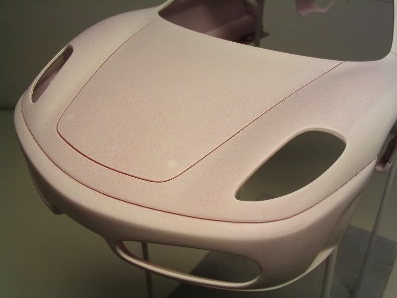

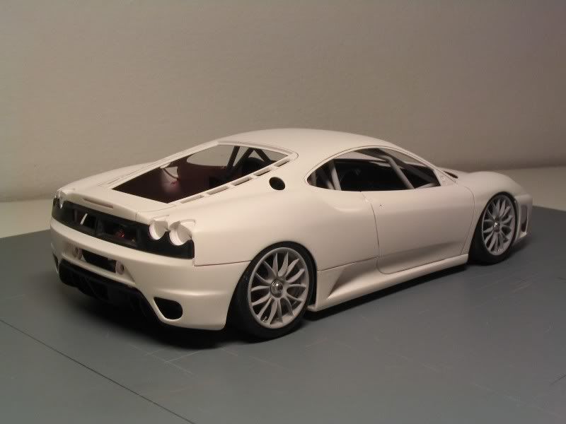

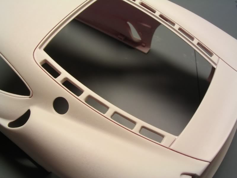

Hi Guys, yesterday I re-started priming the body and I did it with a can probably 5 years old, used once only. I started from the air outlets on the front bumper and what came out from the nozzle was somewhat milky …but not primer. To avoid further tragedies, today I bought a brand new can and sprayed the first light coat
http://i11.photobucket.com/albums/a163/RJ1108/F430%20Challenge/430ch146.jpg
…and this is the missing panel lines from what all the recent mess started…
http://i11.photobucket.com/albums/a163/RJ1108/F430%20Challenge/430ch147.jpg
klutz 100 > chlorine removes the chrome only, to remove the clear varnish (on the rims of my C6-R for example) brake fluid is still necessary
Robi

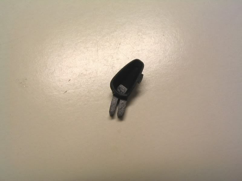

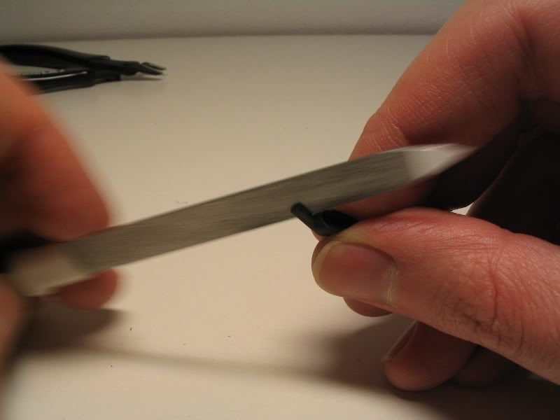

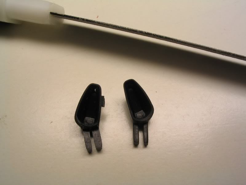

Moving away from the body, I took care about the side mirrors. Not perfectly replicated, this item carries two oversized brackets
http://i11.photobucket.com/albums/a163/RJ1108/F430%20Challenge/430ch148.jpg
Using a very flat file, intended for the nails, I reduced the brackets thickness down to the right size
http://i11.photobucket.com/albums/a163/RJ1108/F430%20Challenge/430ch149.jpg
http://i11.photobucket.com/albums/a163/RJ1108/F430%20Challenge/430ch150.jpg

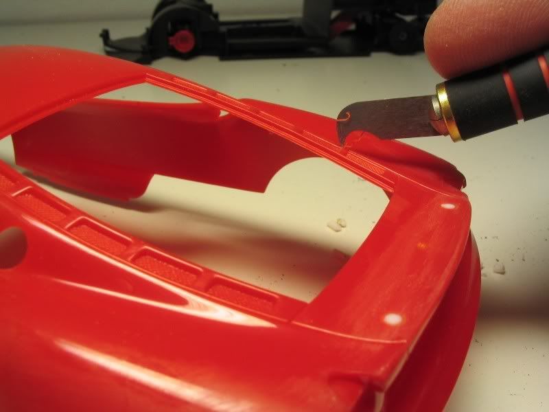

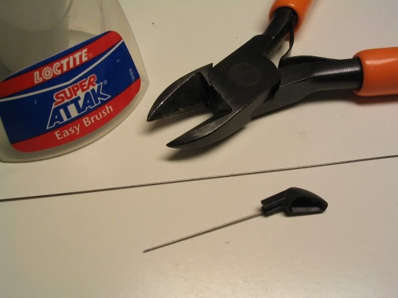

Then, someone at Fujimi, should explain to me how the side mirrors have to be connected to the pillars since no pins or decent recesses are provided. So, I marked the lower bracket with a steel drift and drilled a hole dia. .15 mm / .006 inch
http://i11.photobucket.com/albums/a163/RJ1108/F430%20Challenge/430ch151.jpg
http://i11.photobucket.com/albums/a163/RJ1108/F430%20Challenge/430ch152.jpg
Then I cut a piece of steel rod, the length will be shortened afterwards, and superglued in the bracket
http://i11.photobucket.com/albums/a163/RJ1108/F430%20Challenge/430ch153.jpg
In the body pillar I’ll drill the relevant holes to fix the mirrors.
Have a nice weekend: Robi :)

the 91% alcohol or higher is recommended to strip Tamiya. This
is usually found behind the counter in the Pharmacy . Just ask the Pharmacist
and they will get it for you.:smokin: The 50% stuff out on the shelf just doesn't cut it.
Ariel
ISP is the same hing you find at Walgreens/Walmart, etc....right?
The clear bottle, like $1 per bottle stuff?
Can you strip chromed pieces from the factory sprues?
Ariel

Hi to all. Very tiny update: bodywork has been wet sanded with #2000 grit and drilled holes for the side mirrors.
Using each mirror as reference I visually traced the axis of the holes to be drilled on the pillars
http://i11.photobucket.com/albums/a163/RJ1108/F430%20Challenge/430ch154.jpg
http://i11.photobucket.com/albums/a163/RJ1108/F430%20Challenge/430ch155.jpg
Then I marked the relevant recess with a steel drift and drilled a hole dia. .15 mm / .006 inch
http://i11.photobucket.com/albums/a163/RJ1108/F430%20Challenge/430ch156.jpg
and checked the mirrors positioning
http://i11.photobucket.com/albums/a163/RJ1108/F430%20Challenge/430ch157.jpg
Bodywork and its accessories are now ready for the first coat of TS-26 Gloss White.
Merry Christmas and Byeeeee: Robi :)

Okay, back for a while.
Let’s resume what happened with the painting. At the beginning of December I sprayed the first coat of Tamiya White Primer, followed after two days by the second coat. I left the body naturally dry for twenty days and then wet sanded with #2000 grit
http://i11.photobucket.com/albums/a163/RJ1108/F430%20Challenge/430ch158.jpg
I washed the body, carefully cleaned all the panel lines with a toothbrush and the next day I sprayed on the first coat of Tamiya Pure White TS-26 and a second coat after 24 hours both straight from theb can.
http://i11.photobucket.com/albums/a163/RJ1108/F430%20Challenge/430ch159.jpg
Mounted on the paint stand, I left the body on a radiator (set to minimum) for a week. Everything was okay.
I sanded all the body with #2000 grit, carefully traced and cleaned all the panel lines. Then I sprayed the third coat decanted in an airbrush and after a few hours, reactions started appearing, especially on the roof and the hood. I faced etching problems with the sanded down Ferrari emblem on the hood and some sanding scratches (totally eliminated before the painting process) on the roof, not visible in the photo
http://i11.photobucket.com/albums/a163/RJ1108/F430%20Challenge/430ch160.jpg
I set apart the body for ten days and starting the necessary polishing process. I had to sand with #4000 grit roof and hood, then I rubbed the surfaces with a scratch-remover followed by Amway Glaze and a final touch with Tamiya Wax. For the rest of the body I had minor reactions so Amway Glaze did a perfect job
http://i11.photobucket.com/albums/a163/RJ1108/F430%20Challenge/430ch161.jpg
And this is the result
http://i11.photobucket.com/albums/a163/RJ1108/F430%20Challenge/430ch162.jpg
I’d like to know if someone of you had similar experience, I mean unexpected reactions among the same color brand and etching troubles. I was thinking about the poor plastic quality of the latest Fujimis, but my friend Alex faced similar troubles on his Tamiya Ligier JS11 (original kit) with Tamiya TS non-metallic paints.
Please share your thinking !
Latest but not least, I’d like to thanks all of you for the kind messages, both on the board and private, greatly appreciated.
