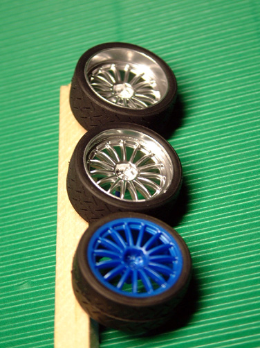

First, in a styren plastic i have made some wheel tyre, join with some putty...
I fixed with glue on the original wheel (2 differents kinds)...
I removed the rear circle of the wheels (circle in blue)...
After sanding and sanding, the wheels are ready for painting...
A small touch of primer paint....
Wheels are painted with chrome spray...
Now, the tires on the wheels (2 kinds of rims)....
Pics more larges....
Rear wheel: more wide than the front wheel....
The original wheel in blue...
The same original wheel in black....

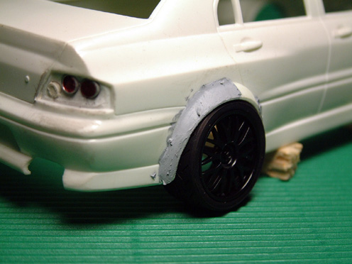

On the rear car.......
At the begining...
The new rims.... nice wide-brimmed wheel.....
