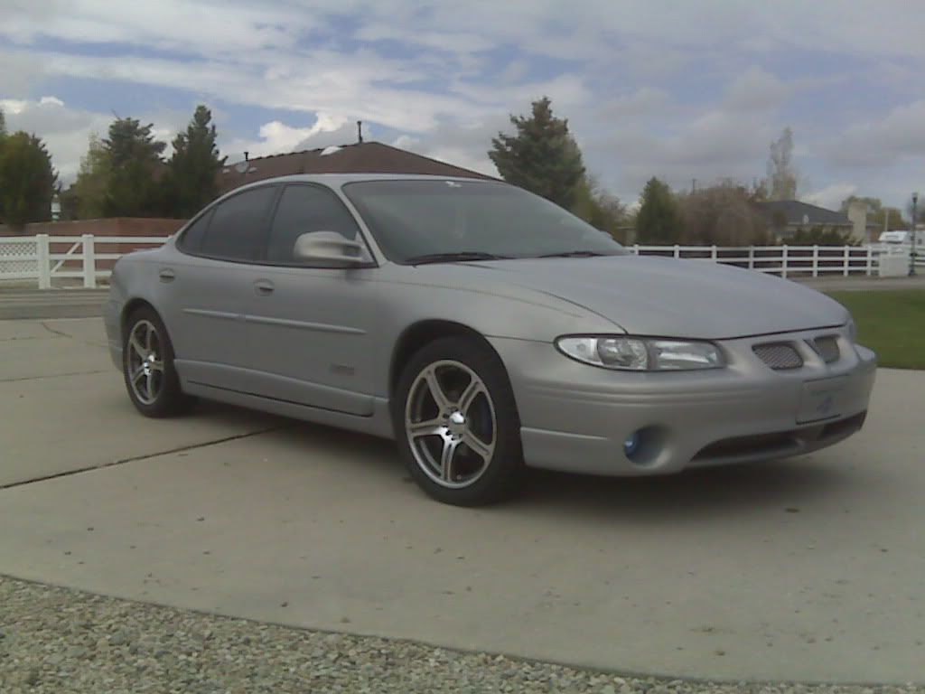

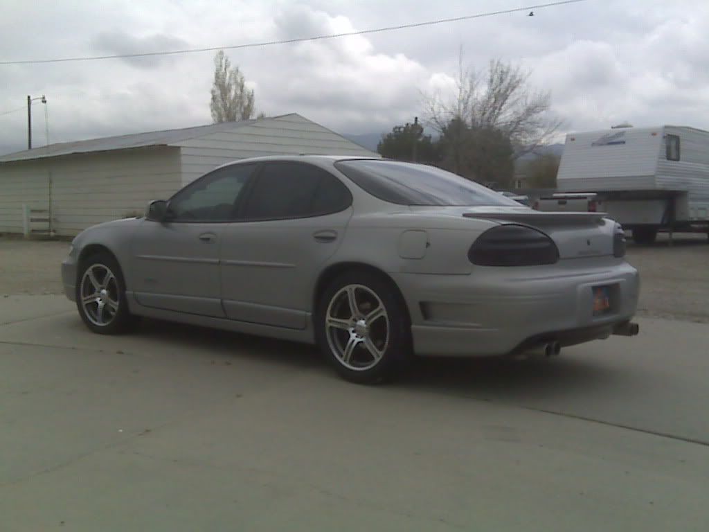

Just picked up the car with the new wheels.

Yeah they look great. I've always been partial to factory rims though (too many bad stories about aftermarket rims bending) but the factory GTP rims look boring so I switched mine to 2007 Pontiac G6 GTP rims (currently looking for a place to powder coat them, the grey just isn't doing it for me)
How much did your tires cost? What tire manufacturer/model? Are they noisy? That's the biggest consideration I make when upgrading. I almost purchased 19s until I looked at the cost of tires and how hard they are to find.

Thanks! I like the factory polished rims too, but if they were only 18's...
I got Falken Ziex 245/45/18 tires mounted, stemmed, balanced, warrantied, rotates, balances and an alignment for just under $600. I did a lot of shopping and that was the best deal I could find. You're right though, going from 16" tires to 18" is pricey compared. The drive home wasn't noisy at all and I couldn't tell a difference in driving really. I made sure to get 5x115 bolt on the wheels because I didn't want to take the risk with 5x114.3's.
Yeah, 19's are a joke. Extremely rare and therefore extremely expensive . It was actually pretty tough to find 18" 5x115's as well.
The bumper I did myself to the stock bumper.
