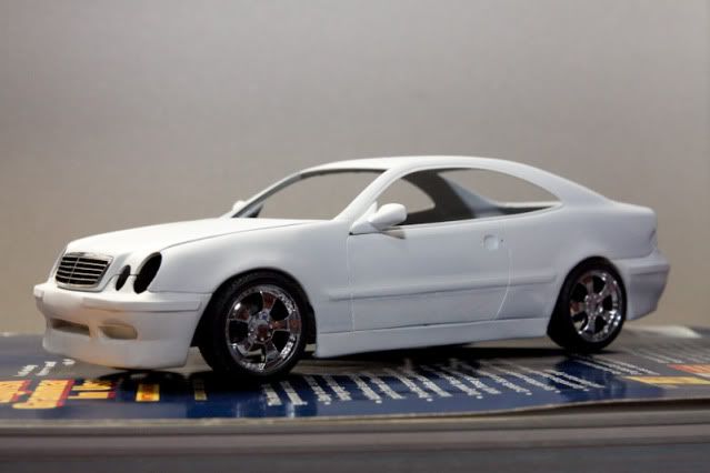

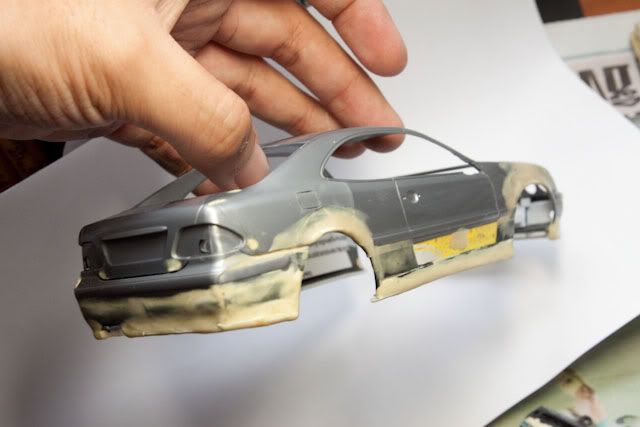

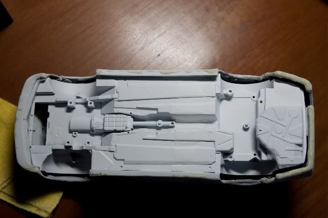

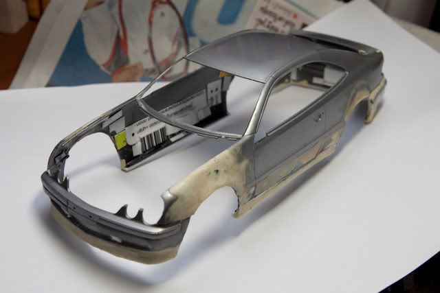

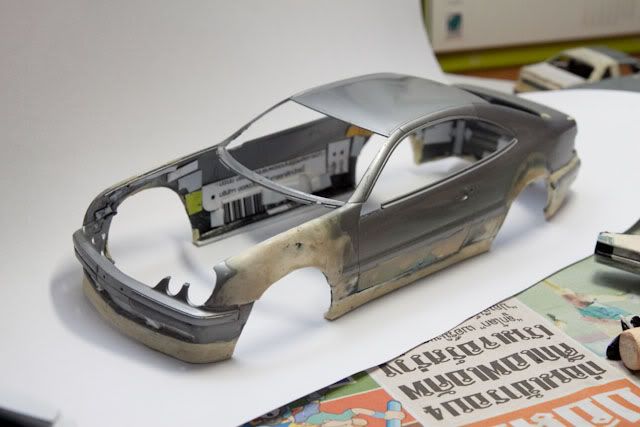

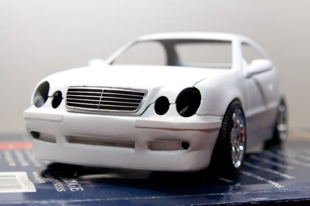

I planned to convert Tamiya DTM body to normal CLK 230 Kompressor. (not DTM-look street version like other) I used many spare parts from SLK Tamiya and S-Class W140 Tamiya. For chassis, I lengthened SLK floorplan since both CLK and SLK are based on C-Class W202 platform. (didn't take photos yet) and the body I cut fenders and bottom of W140 body to fit CLK body and reinforced with plastic card. Fuel door was rescribed. For the interior, I would skipped it since it is curbside model and I want to build it in VIP style with dark tinted window. I'd not to waste the time with almost invisible thing so I will let the space for accommodate lighting system instead.
Let the pics talk to you :

UPDATED!
Still need a lot of sanding
Finished chassis

WIP pics of chassis
