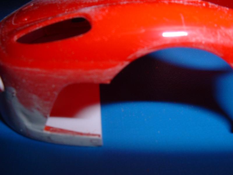

I started taking the fujimi body and placing the first points where start modify the front end and the bumper of the 430.
An old box of a porsche 956 from tamiya is sleeping behind me, this will be the time to take some parts from that model....as the nacas from its tail and the main wing.
I started placing the biggest naca duct into the nose of the 430, and using plasticard (0.75mm) I made the lower part of the front bumper

here we go:
now is time to give correct shape to the fornt of this geetee2,to do this I used 0.75mm plasticard sheet styrene nearly for all, and also cuted the door line cause the gt2 has a different wheel arch in the front end.
The main body remains the standard one (so dunno why many producers made a wider body in the rear part...doh).
Also think will be cool to open a door (driver side) to show the cockpit when the model will be finished.
It is really too better work on very thin plastics as Fujimi one, much better than work over diecast (as BMW) where u can only have a curbside model.
The gt2 also has 2 little holes near the front lights,they should be extra air intake for brakes.The duct were made in palstic (I took theme from the thin plastics u find in kid drinks)

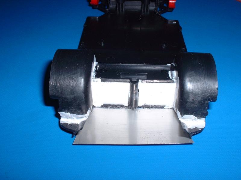

the rear part of the gt2 has different lower extractor and also both the exhausts arrive in a different point than the Challenge version.
To do this I cutted all the lower part of the chassis and remade the extractor with some aluminium coming from a can.The grille hiding the exhaust was coming from a remaining part, not a PE cause they are mostly bidimensional, and I wanted something little more 3d for this effect.
The lateral air intakes (with grilles) have a different shape, and look bigger in size.

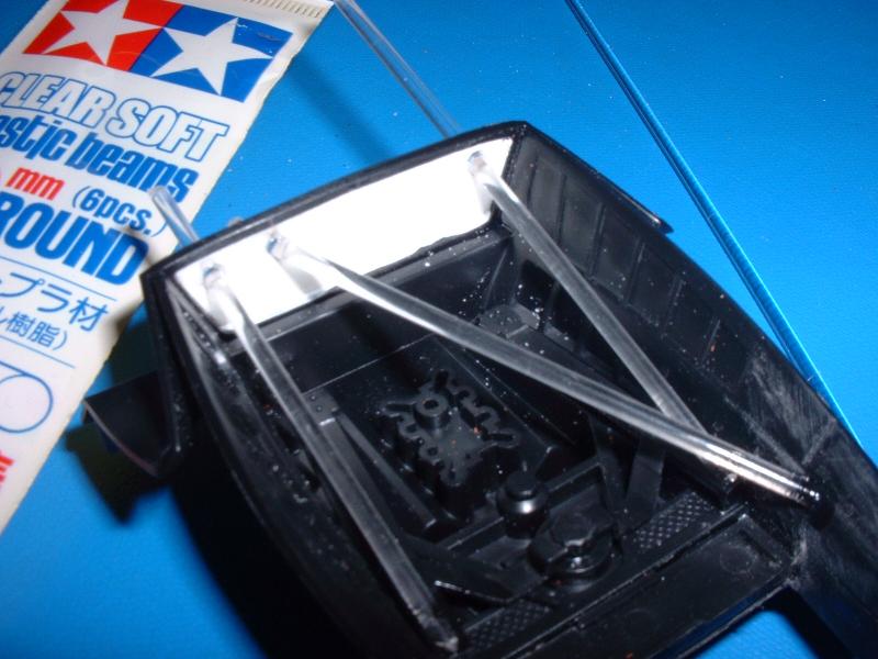

With some tamiya rod I also build the engine part of the roll cage, also here, different from street versions.

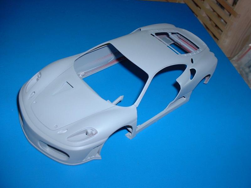

After some finishing work on the front end we are ready for the first coat of grey primer...

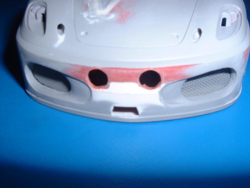

The car used by this team has a bigger couple of extra lights in the front bumper.If u look carefully the real pics I posted short before u can see the 2 yellow ones down there are different.Think this is only on this vehicle.
I used some extra lights coming from Tron 1/43 accessories detail set.

Then I start also to fix the differences between the Challenge's roll cage shape and the FIA GT2 spec ones.Those last are quite bigger and have 2 big X tube to protect the doors side. All was redone using my beloved Evergreen sheet styrene (they shall give an Oscar to Evergreen.Without such, nearly no way to modelling for me )
