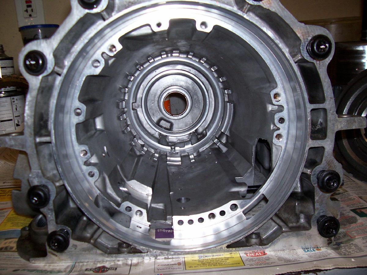

Yes, and like me, he probably ALWAYS uses it so that he doesn't blow the park pawl pivot shaft out the side of the transmission case, like this (crack difficult to see along the right rear):
All it takes is another car or truck lightly nerfing your vehicle while parked, probably not even scratching the bumper, but blowing the pivot out of the case.
I use mine all the time, on every vehicle I have, and don't have a problem. Using the brake prevents unnecessary load on the driveshaft, universals, transfer case, axles/ring/pinion, and transmission. I also follow the manufacturer's recommended lubrication schedules - Perhaps that's why there are no sticking problems?

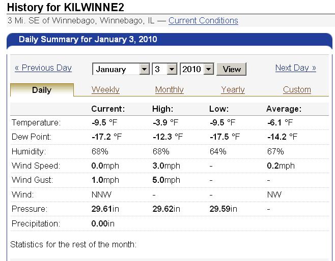

I will, however, offer the disclaimer that it doesn't get that cold here. It didn't even make -10ºF last night:
