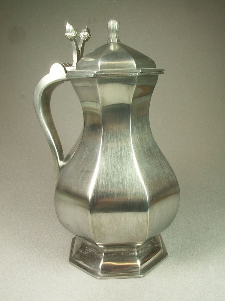

At best, soldering white metal even on it's own is difficult and needs lots of practice. Here's a piece I made from soldered sheet pewter...drove me mad trying to get it right!

And cinqster, the pewter workpiece is an art!! really makes me envy of your soldering job! I must work hard to achieve that... Thanks for all the replies once again!
