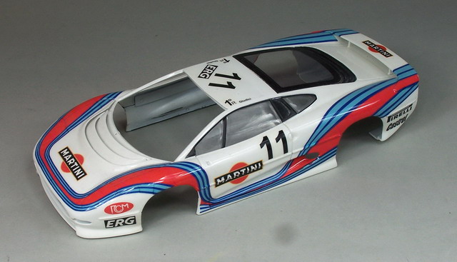

And I'm going to (well at least try to) make it from this kit:
