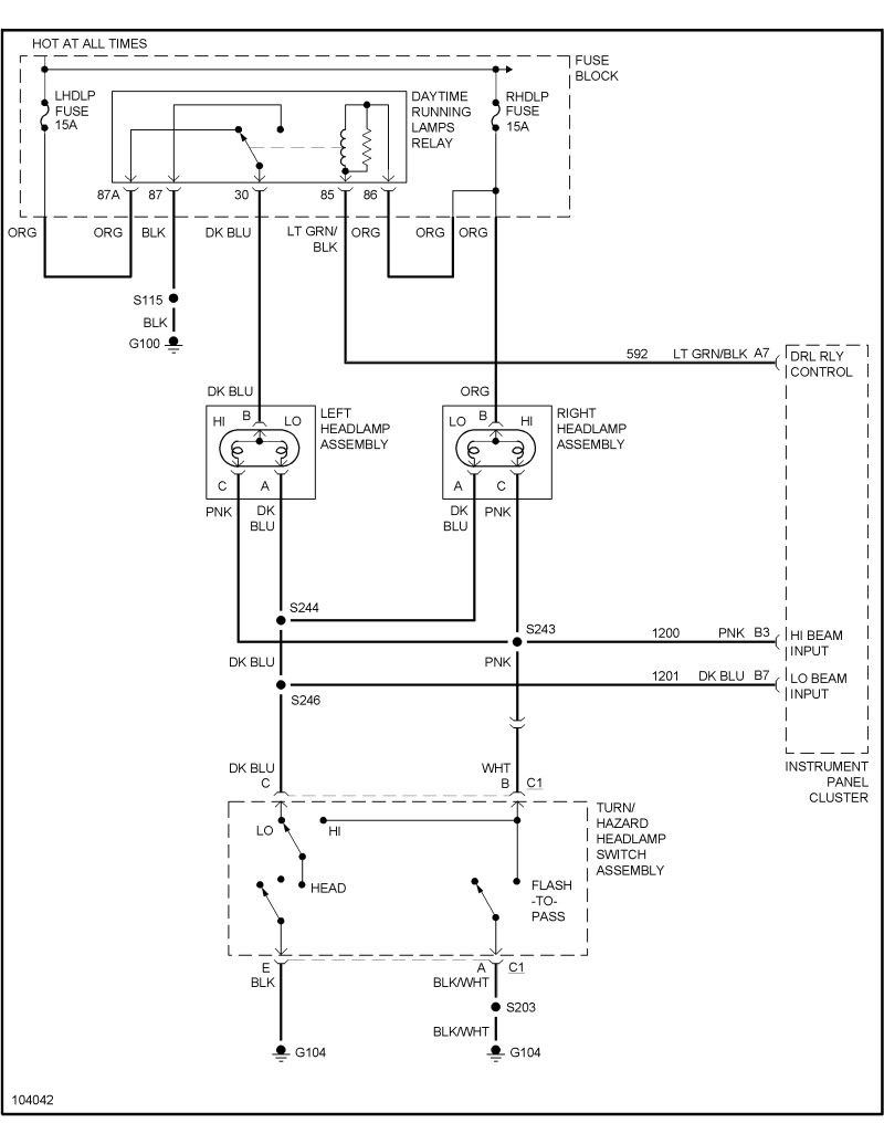

I'm looking for a wiring diagram for a 1998 pontiac sunfire. Highbeam on headlights is not working, and I am trying to figure out why. Low beam works. I've changed the switch, but it didn't make any difference. It's also not the bulbs. Anyone with any info on this problem, or a diagram of the wiring please let me know. thanks

RS, the sunfire is known to have issues with wiring on the headlights. Check to see if you see if there is any power at the switch going to the headlights and trace out the wiring from there. Check along the wiring for power till you lose it that will be where ther break is. Is it both high beams or just the one? I will see if I can dig up a wiring schematic for you and get a copy to you soon.
