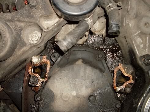

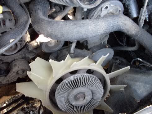

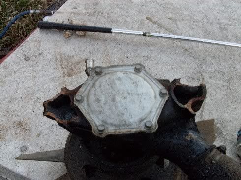

Since my last post I have had a much larger problem to deal with on this vehicle.
In late November the van suffered a catastrophic water pump failure that destroyed the fan, shroud, & radiator as well. (pictures at the end of this post.)
Since this was a very expensive (at least on my budget) repair it has taken me a while to acquire the revenue to complete the repair.
During the"autopsy" of the water pump failure my son & I found that the fan clutch bearings had frozen, & the fan had been spinning on an eccentric. After reassembly the engine has run smoothly. Apparently this was the cause for the engine vibration & subsequent water pump failure. The pump casting showed signs of severe crystallization at the points where the fracture occurred.
Old Master, thanks for the advice on the plugs. I have taken half of it. After reading your post I checked my notes & determined that these plugs had about 90,000 miles on them. I went ahead & replaced them with new Bosch P4 Platinum plugs. I have been running P4s in all my vehicles for a number of years due to the increased gas mileage & plug longevity I have experienced.
Thanks to all of you for your support on this problem.
After my recent experience I would like to recommend that anyone with a GM clutch fan with over 200,000 miles that you keep a close eye on the clutch. Clutch failure is expensive, & at $60 to for a new clutch, replacement could be cheap insurance.
