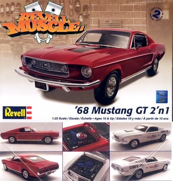

next is either the Revell Bullitt Mustang or the Revell 2 in 1 68 Mustang kit that allows you to build the stock mustang or the Cobra Jet. I need one of these for the hood.
This is where I need a little help if possible. I'm hoping one of you guys may have bought the 2 in 1 kit and didn't use the hood i'm looking for (the stock one). If someone has it I would greatly appreciate it so I don't have to buy a whole kit just for the hood.

I'd probably go with the AMT 1967 Mustang GT instead of the Revell 1968 Mustang. The AMT kit is supposed to be more accurate and should still be fairly easy to find.

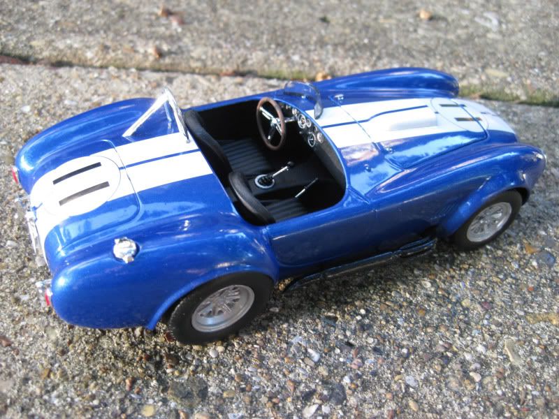

I'm going to get that instead now. I'm fairly experienced at modeling, not as good as some on this forum but I'm good enough.
I've never worked with Resin so any tips would be great.
Heres a few of my models:

P.D. Very nice and clean builds!
