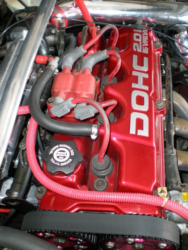

My friend did it for me he has done a few I bought the car with the top of the engine off head etc. I bought a used but good head that came from a 89 eclipse turbo everything is the same (as far as I know) I am a new DS?M owner this is my first. put everything back together and went for the first start turns out bad fuel pump so no start. but as we cranked it over the belt started to walk (away from engine) and it did seem to stop but there is about an ____ part of the belt that is off the cam gears i guess you would call them. i am afraid it will jump and trash everything if i start it.

Here is a pic as you can see on the cam gears there is as tiny bit off center and on the bottom its like the opposite
http://img39.imageshack.us/img39/7044/1014091339.jpg
http://img62.imageshack.us/img62/4033/1014091340.jpg

I can't see too well due to small pic size, but in the second it looks like it might be that the crankshaft gear did not get pressed on completely(which might be why the belt can 'walk' back and forth). Do you know if he pulled it when doing the timing? I don't know about the turbo engines, but on the 420A's you do not need to pull that to get the belt off. If you replaced the oil pump with the timing belt I believe the gear would have to be pulled.

The crank sprocket has edges on it which will position the belt in the proper position. Looking at that first pic, my 420a TB sits about the same position. It's closer to the edge, with more space on the back. Here's a pic
(Excuse the mess... very dirty shot)
If the sprocket is not in all the way, then of course the belt will position properly to adjust. However, it's near mpossible for the sprocket to NOT be in the right position. That would be bad. Is the tension good on the belt?

I was wrong on that it is pretty tight I may be worried for nothing the belt is off center more that the pic of yours it is riding the outside edge and on the bottom pully it looks to be on the opposite edge inside. this is a pic of the twist i can to on top. let me know. Thanks..
http://img118.imageshack.us/img118/9112/1014091551.jpg

Ok that's much better.
As for the position of the belt, not too sure. I can see in your pic that it's right on the edge. If everything is on there good, I'm not sure what the deal is.
