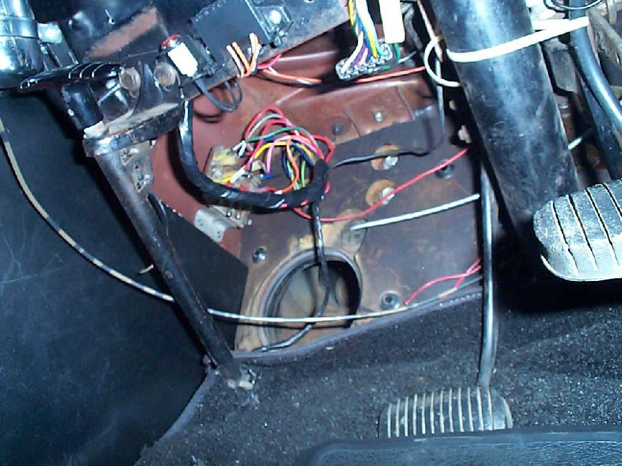

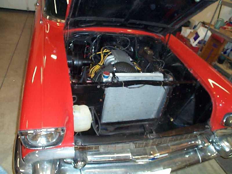

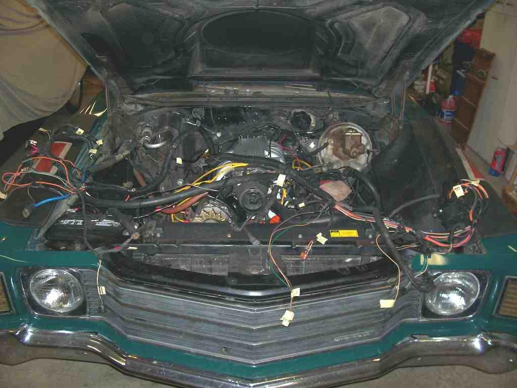

I've done a couple of TPI retrofits, and really strongly suggest you connect the wiring rather than delete it:
Your B-Car should be a little easier since there is already an ECM installed, so the bracket is already there and the harness is partially in place. You can install the relay panel for the TPI under the hood like the stock F-Cars, and route the harness through the same location as the original engine harness.
