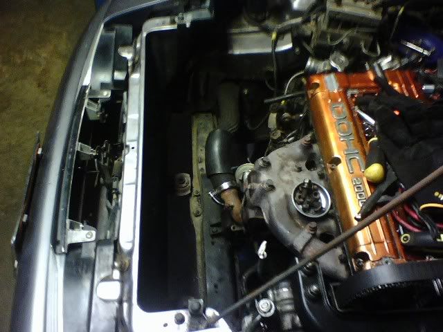

Edit: VICTORY!! Got the O2 housing off, looks like I need a little bit of modifing to get the dump tube to work, as of right now it's blowing straight into the cross member below it. Got quite a bit pulled off today on my day off, here's a couple pics.

I won't be driving it for a long time, at least for a few months so. I don't have a lot of money so that's why it's going to take me all winter to get what I want done. Stuff like the Vacuum line removal is going to cost me under $10 and even replacing the o rings in the power steering banjo bolt is only going to cost me under a dollar so stuff this that I can't wait to get done. I need to get an elbow welded onto the dump tube to make it vent properly other wise I'm going to have too much heat in the engine bay.
See in this pic how the dump is going straight into the crossmember below? Thats where I'm going to get an elbow welded on so it follows the curve of the downpipe.

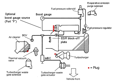

So I want to get the vacuum removal done today but having an issue figuring out what each of the items are in the this picture.
Here is what I'm trying to do
Before
After
See in the top right corner of the first picture where it shows the Fuel pressure solenoid and the Evaporative emission purge solenoid. On the car there are 3 "things" in that corner of the car. In the Chiltons book it kinda looks like 4 things. So I can't figure out what is what, can anyone specify what is what? Thor, this might be your que...your a 1st gen guy.
I'm going to guess that the FP solenoid is all the way to the right but not positive about that.

Figured the above issue out. I have a new question, what should I do w/ the large vacuum line on top of the charcoal canister? I probably shouldn't just plug it but should I hook it back up to the intake or will that create unfavorable conditions? Help
