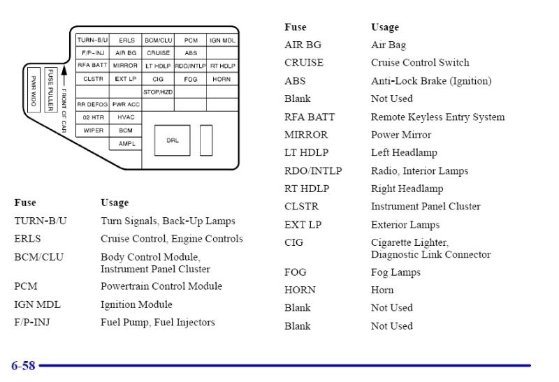

Question Need fuse panel diagram
2000 Pontiac Sunfire SE 2.2
If anyone can get me a diagram of the fuse panel for this this...that would be awesome. You know how some used cars tend to lack the owners manual when you purchase them? Well, this car didn't even come w/ the fuse panel caover.lol
Thanx

You can go to the gm website, click on the owners link at the top, register or login with a yahoo account, click on the add vehicle link, add your vehicle, and you'll be able to download a PDF version of your entire owners manual.

It takes about this long to do
