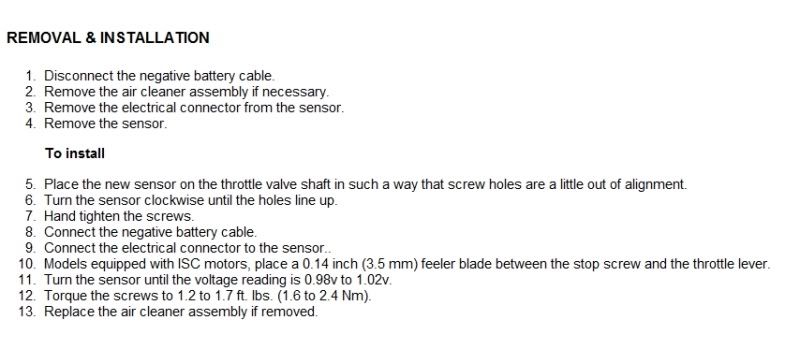

i've always set TPS's by voltage?

Re: TPS- think mine is bad
