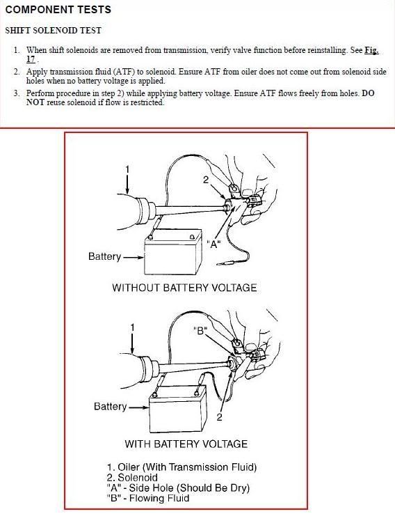

Re: 1997 Geo Metro LSI 4Cly Auto shitfing Problem
What most people do when they have problems with the auto trans is to drop the pan and replace the filter and gasket.
When the pan is down, you can test the solenoids............
