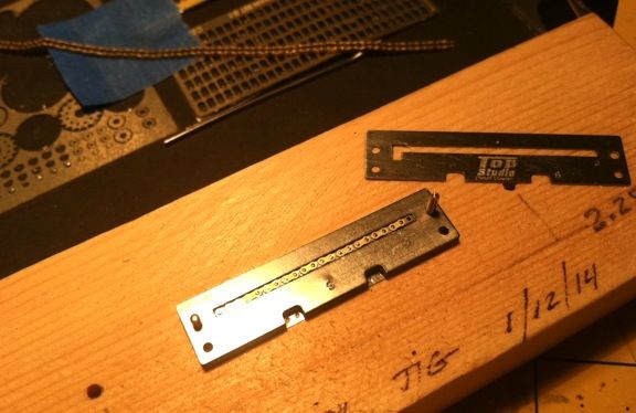

John, I am using Tamiya X-22 clear, thinned with a little water, to hold the links in place. White glue didn't work for me. Yes, I've now built 3 Top Studio chains on a chain jig I made.. It's just 2 holes and a groove in a block of wood, and two brass posts, but it means not holding the chain jig in your hand forever... I can build the chain in about 2 hours with it... Marco

Marco, can you please give me a little more detail on your jig? What is the groove for? Any extra tips?

The groove is because as you build the first side, the roller pins will stick out of the chain
on the bottom side, and it will not lay flat otherwise.. I have now cut 2 grooves across the
jig, so I can insert and grab the chain jig with 2 pairs of locking tweezers, to turn it over
when it's time to build the other side... Hope that helps Marco
