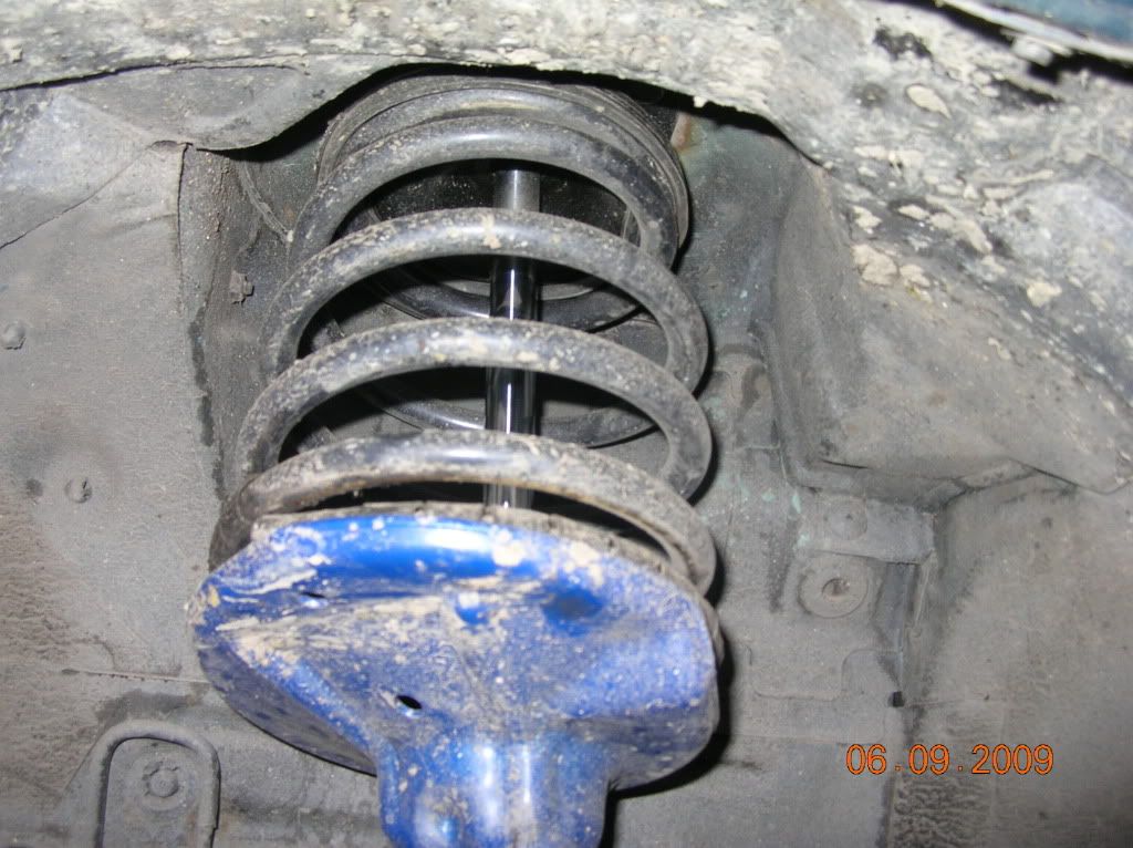

Here are some pictures i took today after I intalled two new sway link kits.

You have done a lot of good work! If you replaced the upper spring seats ... did you compare shape and size of old to new? How about the end shapes of the springs?
On one strut top (the LH side??), there looks like one stud is short ... did you shorten it?

.... also looking at that top photo, that spring needs to be rotated about a half turn to be seated properly in/on the strut-shock formed sheet metal "shelf". How did that happen?? That ain't right! I suspect that would put a real bind on the strut-rod.
Of course, I could be looking at the photo wrongly ... and am all wet!

I see the same thing.. looks like it needs a half turn to the right. The bottom end of the coil should settle into the indentation formed in the seat.

I see it too. It looks like the base of the spring is pointed in the wrong direction to seat. It definately is not right.
