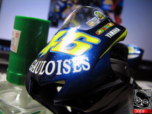

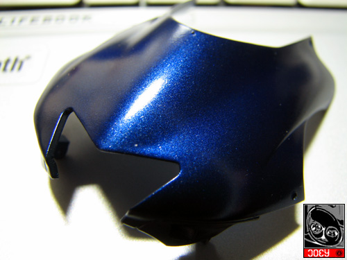

Hi Brothers,
Having a great fun from the Top Studio transkit for '04 M1, I was just had enough at the moment and would like to get some lighter and more relaxed builds. LOL~!
This was actually been started back in 2008 August. But I barely touch it after the fairing is polished. I think I can treat the chassis as a seperate kit now so I can focus on the details around (without the transkit).
I hope I can be doing this soon after a couple of 4-wheelers are done.
Please also find more text descriptions about the progress I have written on my own web: http://www.joeyko.com/diary/rossi_m1_mal_2005.htm
I am glad to have any comments of any kind.
Enjoy~
Joey

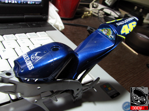

Paintwork looks flawless. I wish I could do all the cowls before I start with the details and frame/engine. I sort of go everywhere at once...

is that telefonica blue youre using? its a very nice color.. too bad i never managed to succeed painting with that color... T_T

Bodywork looks fantastic, nice work so far

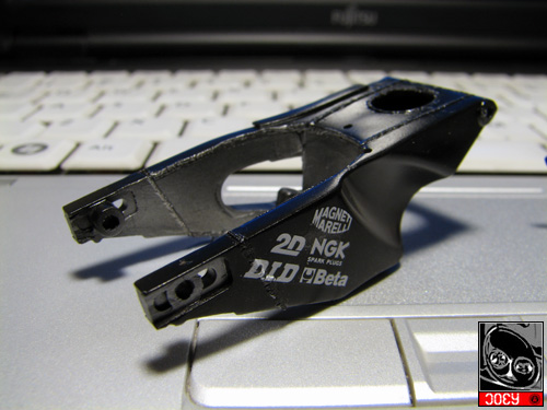

A little update from the weekend.
Since I didn't apply TS trasnkit for this kit, some new aftermarket parts are in use for details. (but i guess those metal tuned parts still cost me a lot.....LOL)

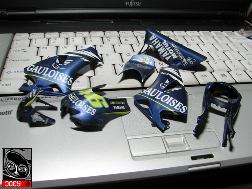

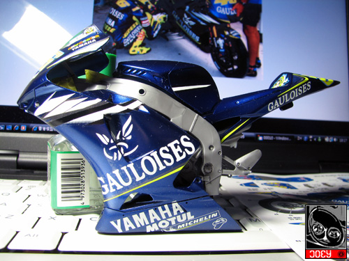

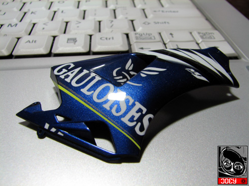

Nice progress!! I forgot to ask... on the body you first applied primer next colour decals and clear and then did you sanded with P2000 and applied compound? I want to use that product for my next build...

To Roca46: my steps are as follows:
primer > sanded lightly with 2000 sand paper to smoothen the surface for paint >
Gunze Gloss black as a base coat for metalic blue > metalic blue from Ricebox >
a thin layer of clear coat as to seal the metalic paint before decals > decals >
clear coat that is thick enough for polishment > sanded with #1500 sand paper to flaten the stepping effect from decals >
sanded with #2000 sand paper for smooth surface > polishing with Modeler compound 2000 for gloss.
these steps are almost identical to the rest of my recent builds. I had put an article about polishing or better say car model body processing in chinese in my web site. i have translate about half into eng in fact, but i have been too lazy to complete that.....
but i guess the pics inside may still help about knowing the concept behind.
hope these help~

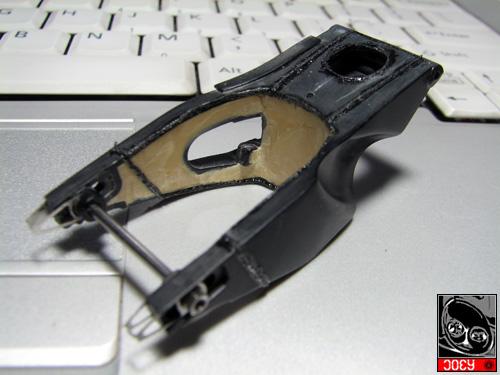

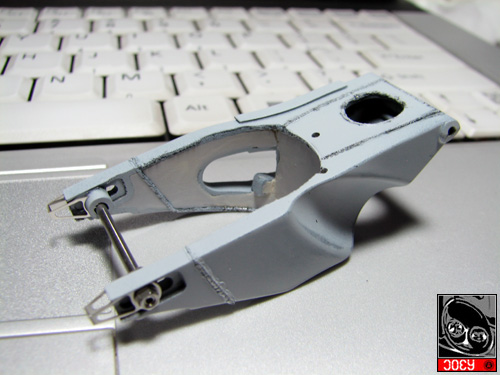

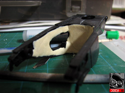

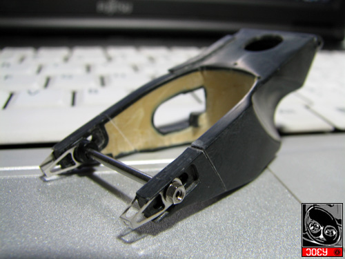

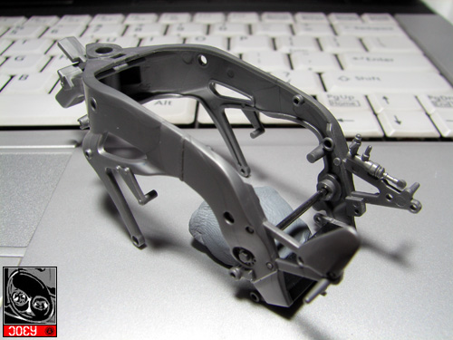

Added the weildings on the swing arms. And then I got the whole thing primed.
I am just about to accept the result. I may have to round a bit those weildings to make it softer and be more natural........

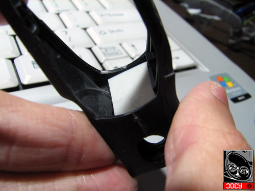

Coming next will be the main frame. I am not going to fill the insside with putty as I found it hard to be smoothened with those junctions and joints. As I probably will not open up the fairings after it is finished, I would prefer to save those sweating.....

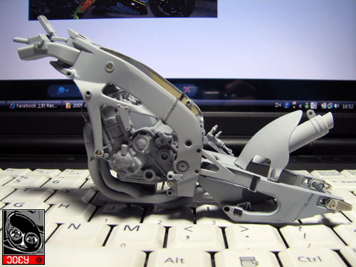

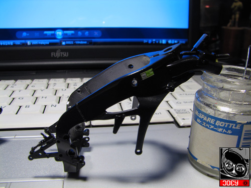

Some more update over the weekend. The main chassis is touched up and was painted together with the swing arms. Some decals are applied over it and to be coated with a little flat clear coating (hope to give a semi-glossy effect this time than just a matt layout)

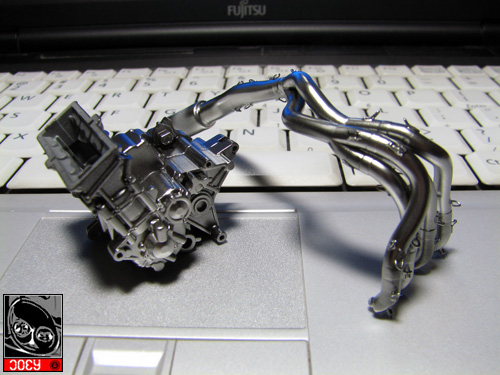

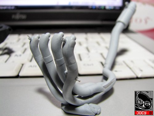

And I started to paint the engine and exhausts as well. I used SM07 on this.
Many people have asked about what chrome to use on these kind of exhaust. In my own thought, since Alcad #107 can easily been tuned down by paints on top of it, I really don't think it is a good option for bike's exhausts even its chrome is superb. And since I will be doing some more work on top of the silvery, I am using Gunze SM paint to make sure the paint stick with the ground and not being tuned down by the clear colors that I am going to put on it.
MY WEB SITE : www.joeyko.com

I can see that you finally filled the inside of the frame with putty... well done . Fantastic work on the welds!
Roca.
Old 06-15-2009, 01:28 AM
joeyko2000's Avatar
joeyko2000 joeyko2000 is offline
Join Date: Jan 2004
Posts: 430
Thanked 5 Times in 3 Posts
Re: Rossi in faith - M1 2005 Sepang
Originally Posted by Roca46 View Post
Great job!
Roca.
Yup. Finally I changed my mind and get rid of it....
But I didn't really do it so well as I have clued the parts together before, so the sanding job is much more difficult and I didn't do it completely at all....
But afterall those were not so visible and I think this taught me another lesson anyway.
