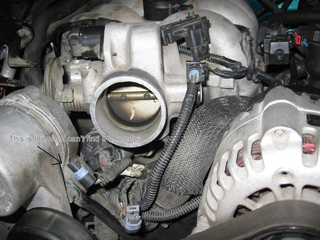

I reassembled everything and still no luck on getting it started. There is one connector that I can't seem to find where it should plug into and I really hope this isn't what is preventing me from getting started.
The connector looks identical to the IAT sensor plug but I can't seem to find anywhere it would potentially plug into.
UPDATE: the unknown plug is for the coolant temperature sensor down hidden on the front of the engine.

While you have the air intake off, clean your throttle plate and the bore. It looks a bit dirty...
There is two there that should be plugged in.
One with pointer looks like Air intake sensor on air intake hose.
Always install air intake hose before starting and plugin all sensors.
Are you getting good spark to plugs and good fuel pressure?
Good Luck
So if the one I am pointing to is the air intake sensor what is the one to the bottom right of it for then? If I plug either one into the air intake sensor I can't find a location for the other. Kind of baffled buy it.
I need to work on figuring out if I have good spark and good fuel pressure cause I am pretty confident TDC is correct but it still wont fire up.

Yes

I tested with a multimeter and I know I have power at the coil and at the coil wire before plugging into the distributor. When testing for actual spark at the plugs I pulled both cylinder #1 and cylinder #4 and there was no spark when trying to crank the engine. Does this mean I should invest in a new cap and rotor to fix the problem?
Without getting a fuel pressure gauge its anyones guess if thats good but I don't see how it could have changed when it worked before I replaced the gaskets. When I have the upper plenum off and I hand crank the engine to find TDC I can smell fuel if thats worth anything. In addition while cranking the engine I could smell gas coming from the cylinders I removed the plugs from.
For the mystery plug if one is the air sensor then what could the other one be for? One is marked PED 68 and the other is marked PED 16* where as the one that plugs into the EGR valve is marked PED 2.
