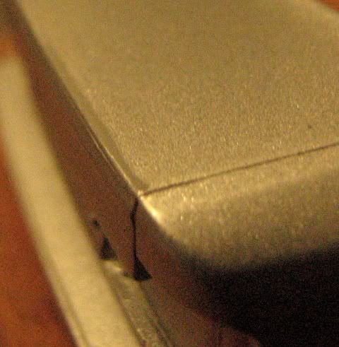

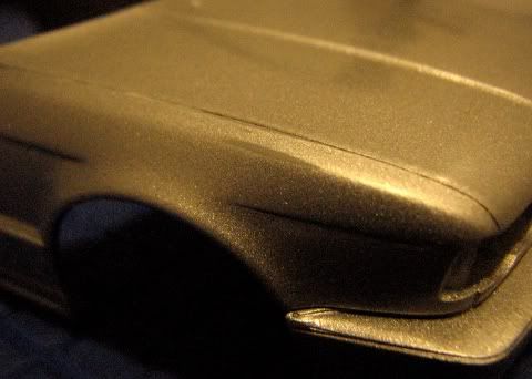

OK now, some pics of the problem, not good ones I found quite tricky to shoot that silver color.

That should be an easy fix especially since its silver. I would lightly sand the paint surrounding the area you burned through just to help make a level surface. No rougher than 2000 sand paper. Mask the area off. Then spray the silver, don't patch spray it, spray it as though you were motioning your hand to spray the entire body, once it starts to look level or uniform with the rest of the body, then you can clear it. Make sure you put alot of clear on your body's next time if they are metallic paints.
