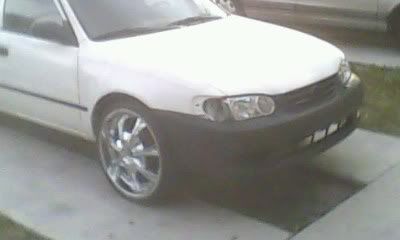

i bought one of the last pair of rims they are tis and also their 20" i put them on my rolla on the front and they fit perfect but in the back it wont let me put them because of the strut what kind of strut can i use rather than the stock ones,

<a href="http://s79.photobucket.com/albums/j1...t=IMG0090A.jpg" target="_blank"><img src="http://i79.photobucket.com/albums/j1...5/IMG0090A.jpg" border="0" alt="Photobucket"></a>

You'll have to either use wheel spacers or use a narrower wheel. I'm not aware of any special struts or strut relocator kits you can use, short of custom fabbing it. This is why fit-up to check for clearance is important BEFORE you buy new wheels. Hope you kept the receipt...too bad, they look good.
Good luck!
