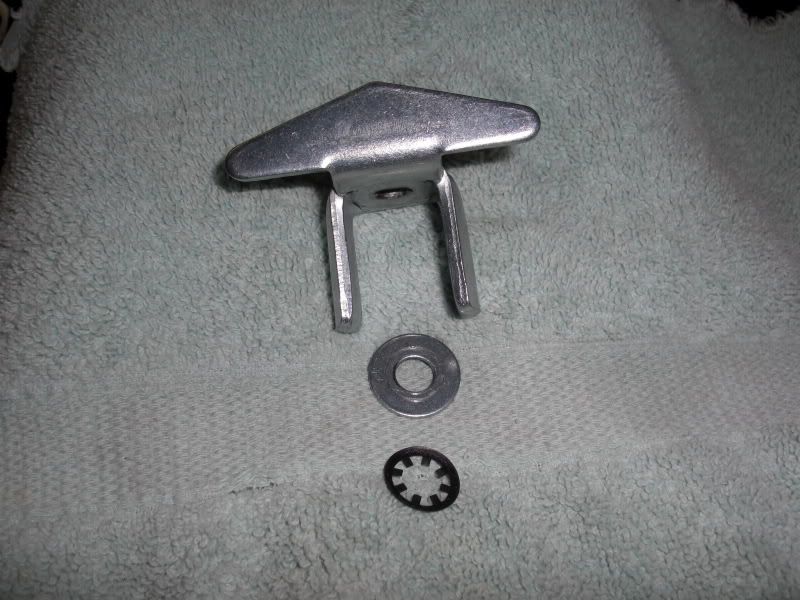

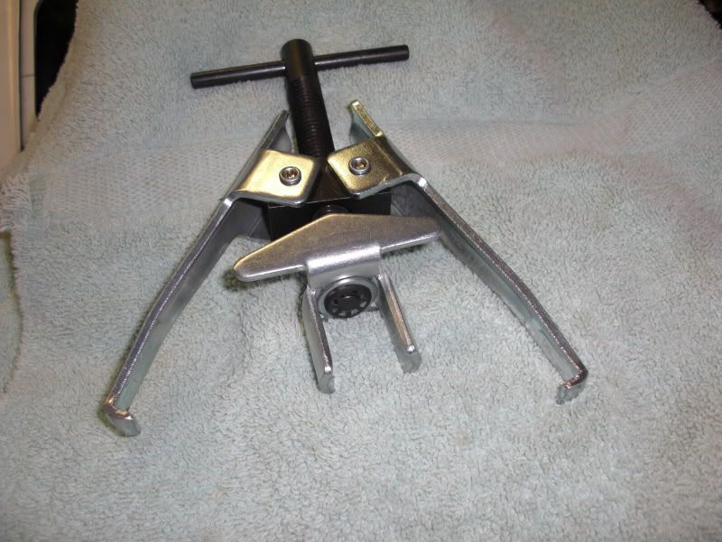

I bought one of these spring compressors at Autozone ($13), but they are available everywhere:
You can use it as is to compress the valve springs on one or two of the metro valves but it wont work on the others. You can also buy a large "C" type spring compressor but most of the ones I saw did not have a tip that would fit onto the metros recessed valves.

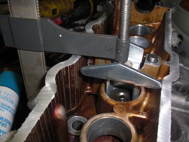

I had a carpenters clamp in my garage used it and the head off of the Autozone compressor as follows.
I removed the head by prying off the lock washer:

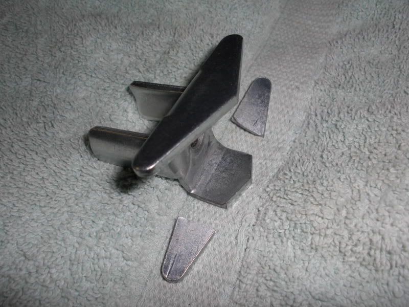

The "wings" on the tool head came in contact with sides of the engine head when I tried to use it so i cut off two of the wings with a Dremel:
Then I used the carpenters clamp with a rag on the combustion side to hold the valve in place. It was easy to put the keepers in with the spring held down:
I'm sure there are many other ways to do it but this worked pretty well for me.
