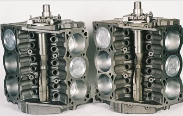

Here is a pic I scanned in from my 3800 engine rebuild manual. Did you check all 6 pistons?

Yes, all cylinders overshoot the block.

about 1/16". Thats probably gasket thickness, bnaylor said thickness was .062. I was just worried,because I've had heads off of engines before and had #1 piston at TDC and never saw or noticed this before.

Do you have access to another block to inspect like at a salvage yard?
1/16" is around .062" or 1.5mm. About what the gap of a spark plug is.
I'm quite sure this is normal and has something to do with the higher compression ratio provided by the pistons in a L36 engine. Did you use a feeler gauge or other source of accurate measurement to see how much the pistons come up over the top of the block?
