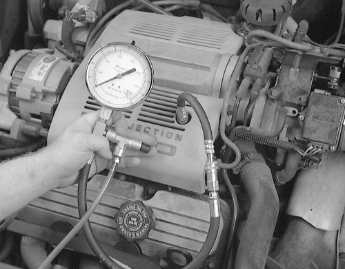

and here's a backyard-mechanic way to relieve the pressure in the rail before servicing (of course after you open the gas cap, pull the relay and crank the engine a few times)
then instead of that gauge on the port, he'll introduce the cleaner canister instead:
LOL, watch this youtube vid link... but it's just that easy to do!

My suggestion is to use a few tank fulls of a name brand premium gasoline only because it has more detergents in it supposedly and put in a 20 oz size can of Techron Fuel System cleaner available at Advance Auto or Meijers or Walmart. Walmart has only 12oz cans ($5.95) so use 1.5 cans for 18 gallons of fuel.
Let that clean the injectors. When fuel tank is low, repeat with one more tank of premium. Lots easier and it will surely clean things. I'd change the fuel filter AFTER I ran the Techron in case it moves stuff from the tank to the filter.
