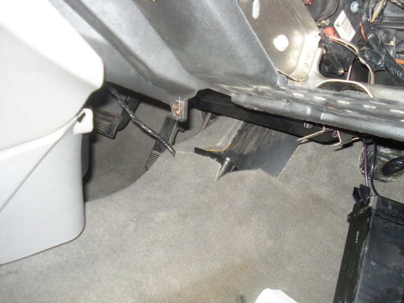

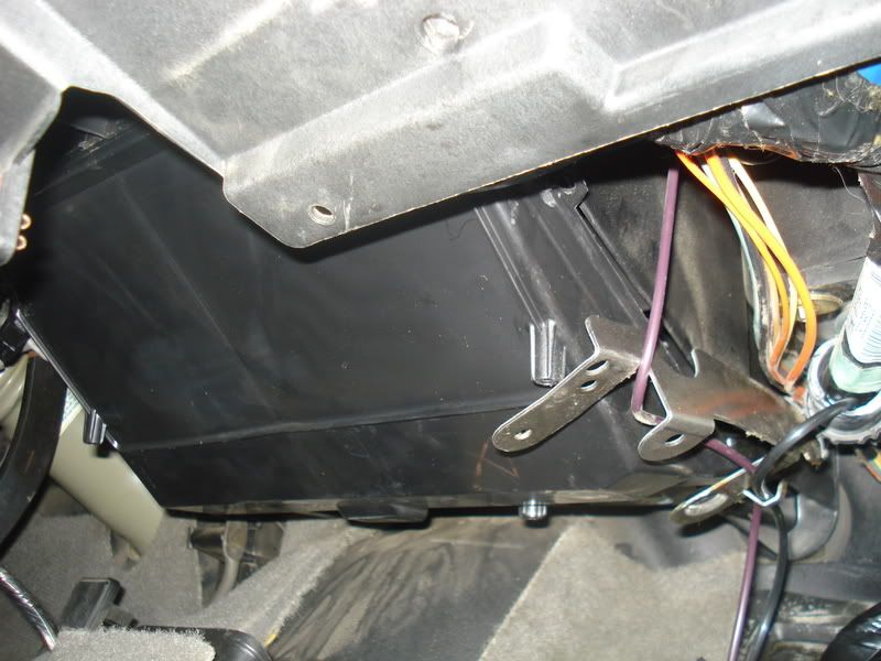

These are the only pics I have in my collection that may help. First pic shows the vacuum lines. Black incoming and purple outgoing and to the right of the second pic the vacuum tank. Easy to damage those lines when doing a blower motor or resistor job. But check the black plastic vacuum line at the engine compartment first.
