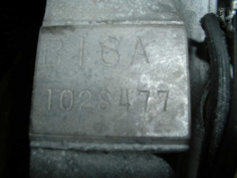

Alrighty, here it is... After some frustration and headaches, the swap is in... I got my motor from steve over at hmotorsonline...
Its a b16a/s1 trans...New timing belt/water pump and all new fluids and such... I'm using the stock clutch for now.
Aight here goes:

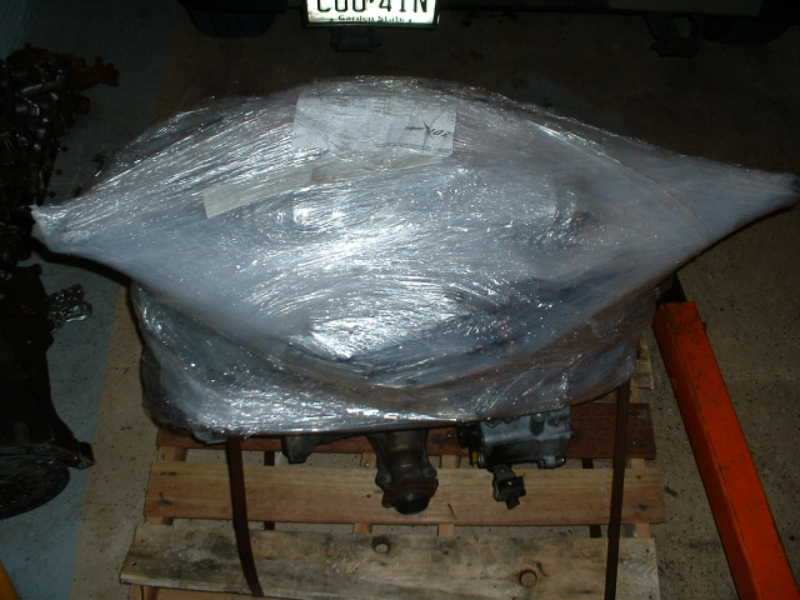

My motor arrived tightly packaged and pretty damn clean...
Only problem was the alternator belt, which I replaced with one from a 99-00 si

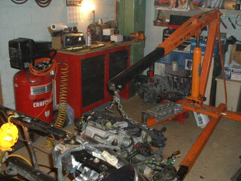

here is where it all happened:

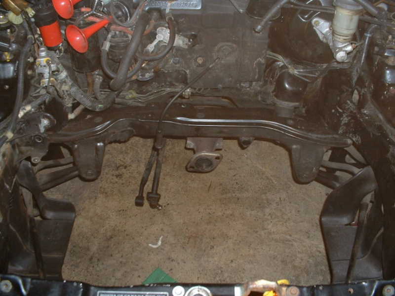

bang out this area for alternator clearance:
my dad grinding away at the front mount
and finally the motor is in

why only 3 mounts? what kit did you use? why not 4 mounts? my HCP kit is a 4 mount kit

Nice swap. He used the Hasport kit which only requires three mounts due to the durometer of the solid polyurethane bushings in the mounts

yeah...obviously the 4th mount will help a bit..but the real reason the designers put the front mount in there is to help with support in an accident..

cool i was wondering if i really needed that 4th mount, now i guess not.
and to help stiffen the chassis.........the 4th mount is a GOOD idea and BTW the HCP kit that i have is 4 mount with polyurethane motor mount inserts as well

-- I ground off the front mount AFTER I put the engine in -- oops.
-- The cat bolts were perma-rusted on. I ground those off too.
