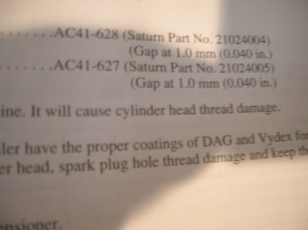

hmmm..well my 97' came with AC Delcos from the factory because I removed the factory set myself. I still have'em.
Here is the specs from my owner's manual where only AC plugs are recommended.
AC 41-628 for SOHC
AC 41-627 for DOHC
