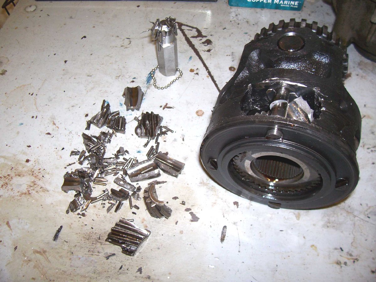

Envoy uses a completely different driveline than Lumina and other W-bodies. A Lumina can exhibit those symptoms when this happens:
While an Envoy can act the same way when this happens:
I've had both, and of the two I would rather have to deal with the longitudinal transmission (Envoy) than the wrong-wheel-drive version.
