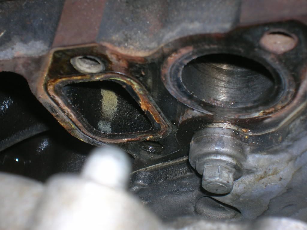

It looks like you were correct about the water pump gaskets. I looked under the WP gasket location on the pass. side and I saw it was wet. There's only a small space to look through, but I saw some liquid shimmering. So I figured I would give it a shot and change them. It sounds like it's only a matter of time before they start to leak anyways.
This is what the passenger side inlets looked like. The bolts were all caked up with gunk and corroded from coolant leaking into the WP mounting holes. So I cleaned all gasket surfaces and bolts down to the bare metal and applied the new gaskets. Flushed the entire system out and went back with new Dexcool and distilled water. All seems well so far. No wet spot under the gasket points anymore.
So hopefully problem solved.
FYI..The GM dealer was cheaper on the gaskets than Autozone and Oreillys. I didn't check Pep girls.

thanks for all that and the pictures...yes the coolant is very important here in these engines...not like when they where all cast iron...
corrosion is the killer...and its very hard to completely remove all the coolant when the time comes to service this.. good luck..
