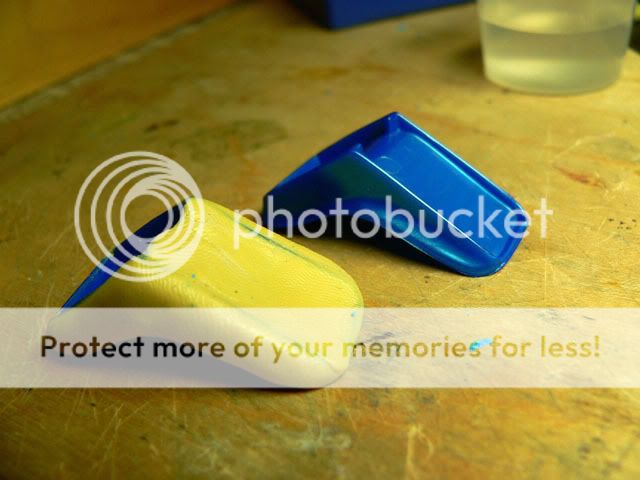

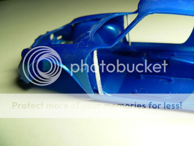

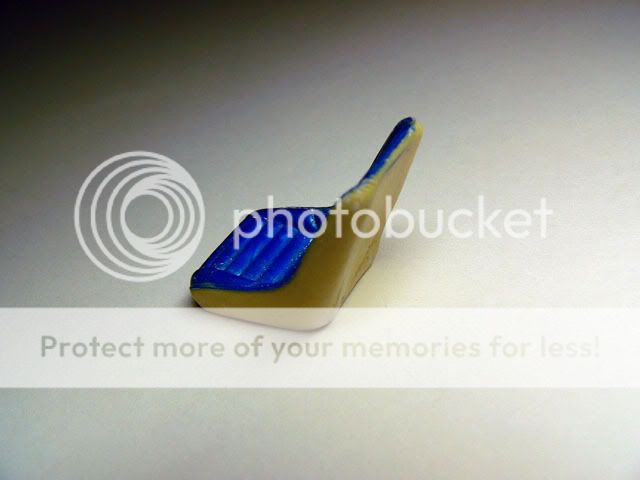

Here is weekend update!
Looking at the photos of real car, I found, that Tamiya KIT is a stock car 1973 with another weels and racing decals.
So, let's start modificatins:

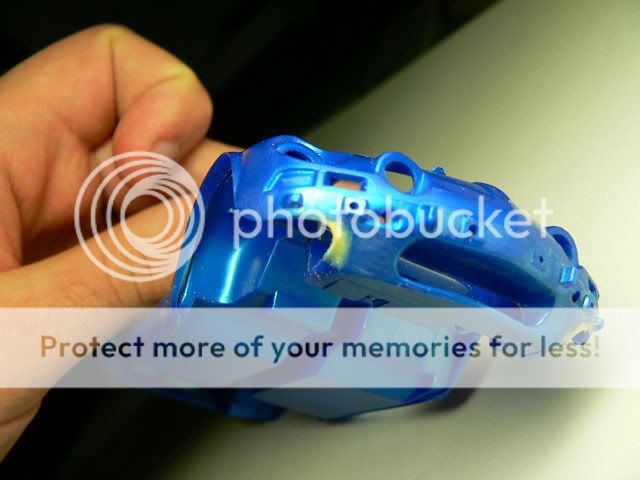

Front:

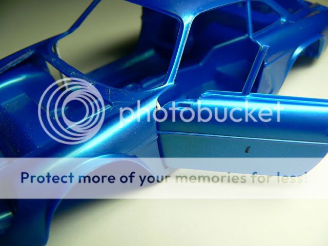

preparation to setting of door loops
Open door will looks like this:

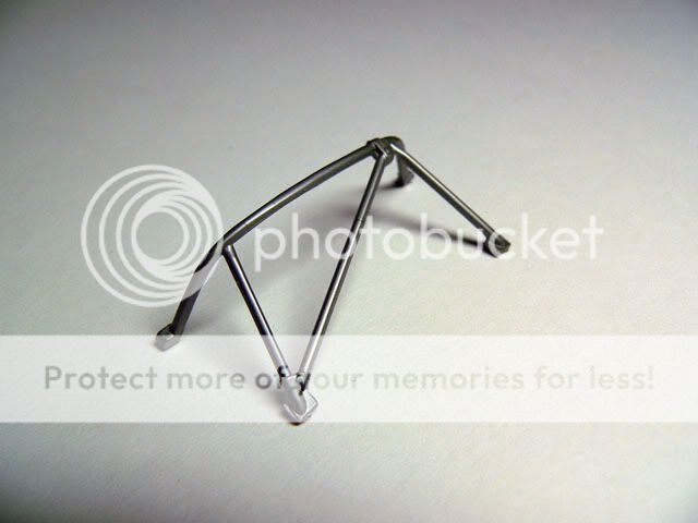

safety framework

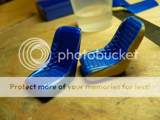

And in the end - correct seats
Thank you for looking our chanal

Wow. A couple of things:
1 how did you work out the front guard/undertray needs that mod? I have most of those photos from my rally books but I haven't seen anything that shows that part
2 what did you use on the seats? It looks like some sort of plastic putty car body repairers use (we call it bog here in Australia)
Great start BTW. Want to see how this turns out. Is this a one-off or do you plan to do any others? Could be a long prod'n line if there are others waiting...

2 Seamus McRae:
Here, on this photos, we can see correct shape of the front undertray.
There is some more mistaces in Tamiya KIT. about it I will say later.
Unfortunately, I have only one KIT oh this beautiful car
But sometime in the future, I want to build another one in stock.
