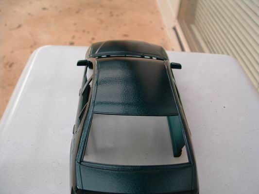

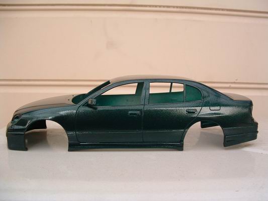

Interior - needs some touching up with a brush. Colours used were flat flesh, german grey and flat brown
Body - finished painting yesterday with duplicolour automotive paints (3 wet coats) and 3 coats of duplicolour clear
Wheels are going to be from the Tamiya 350Z. Since I don't have a dremell, I had quite a hard time getting the wheels to sit well in the wheel arches. Thinking of adding a SAS wing too.
Question - there is quite a bit of orange peel on the body - what grit of sandpaper do you guys reckon I ought to start sanding with (after about 7 days or so)?
I would suggest using 3600 grade or thereabouts, If you cant get hold of such fine grades then 1500+ will do. I have acheived mirror finishes on auto paints sanded with 1500 followed by lots of rubbing with the appropriate rubbing compound. The great thing about auto paints is that they are very durable and very forgiving, if you put the work in you will get this model gleaming!

Just some tips using Duplicolor paints: you should spray them on thin, and you should spray a LOT of coats. Hawk312 uses as many as 10 coats of Duplicolor Clear before he's ready to start polishing, this is cause the Duplicolor Clear is so thin. Also, don't spray 'wet' coats in the sense of flooding the model with paint, as it won't dry even. Then you can start polishing after it cures (which the can says takes 48 hours.)

That's because he didn't prime it with the right primer, and sprayed too thick. Duplicolor is a lacquer paint which attacks plastic, if you use a good lacquer primer it won't.
