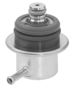

Thanks for the tip. Is the FPR located on the fuel rail and what does it look like?

The FPR looks like this. Located on the front fuel injector rail. Mounts into a bracket. Help by one snap ring retainer. The vacuum line is visible in the pic. See pics below.
