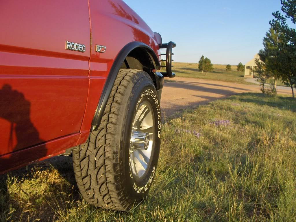

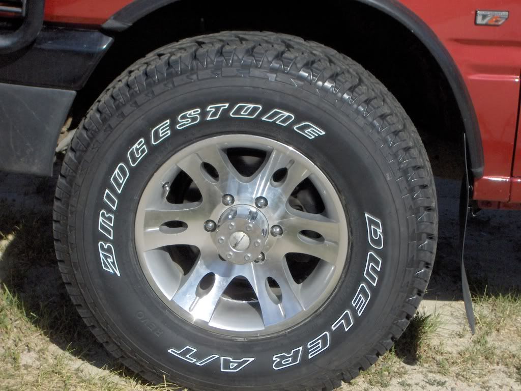

I drive heavily snowy/icy roads here in Colorado's high country, and in fact, many times I can get through this crap in my truck better then most 4x4 owners.
I run Bridgestone Revo tires, they are pricey, I'll grant you that. But, when one has a 4x2 in snowbelt areas they need the best tires they can get.
These tires make this truck act and feel like a 4x4, and in all of our 12yrs of owning this truck, driving through sand, thick mud, snow, etc, we've only been stuck once, that was with our last set of tires, Yokohama Geolander A/T's of which I won't purchase again.
Revo's are an excellent all around tire, they are magnificent in the rain, run good on the highway, etc. They are considered an all terrain tire and last quite a while on these trucks.
Take a look at tirerack.com and you can look at the reviews of these tires.
Don't fall for the gimmick of the BFG A/T KO's having the snowflake symbol and being better then the Revo's, I've had both sets of tires, the Revo's leave the BFG's behind in the snow and ice.
