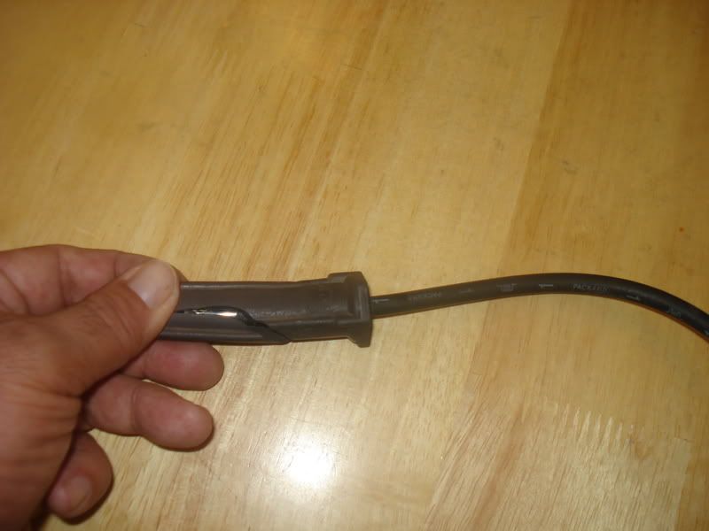

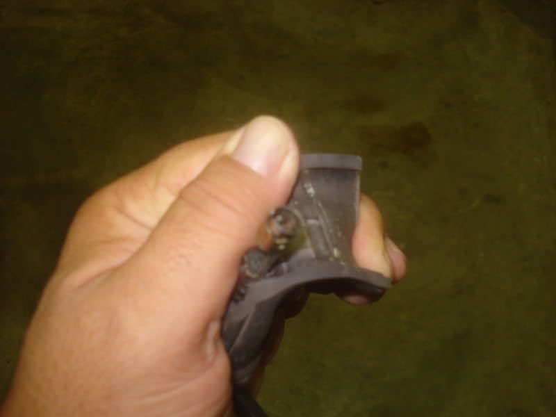

It may have looked dry but that doesn't mean no dielectric silicone grease was ever there from the factory. That stuff gets old with age and due to the high heat of that part of the engine - cylinder heads and exhaust burns off or deteriorates or drips off. The temps are well above the maximum temperature rating of any typical dielectric silicone grease. Add 10 years to that and no wonder. The stuff doesn't last forever and has to be reapplied sooner or later.
I still had the original Packard ignition wire from cylinder one that I replaced about 5 years ago in my '97 GTP. After cutting it open I could see some remnants of the original dielectric silicone grease GM used. I recall it had a greenish tint. When you touch it feels all powdery now. See pics below.
