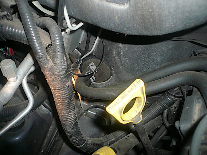

Is the heater hose from the engine going thru the firewall hot? If so then it is a blend door problem or limited circulation in the heater core. If the hose is only luke warm then it is a thermostat stuck open or a blown head gasket.

Both top and bottom hoses are pretty hot. Not sure which is the input and which is the output though. Here's some context:
