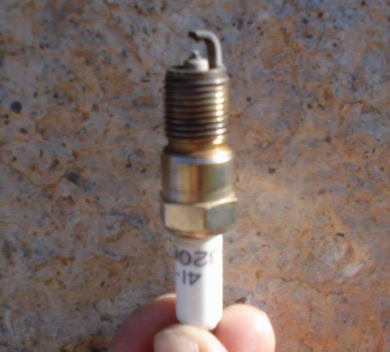

The plugs are more than likely an Iridium plug, ACDELCO Part # 41101 with recommended replacement @ 100K. If they are original, you are pushing the limit @ 140K! If they were replaced, you should be fine with plugs. BTW, they should have a “bump” on the ground strap of the plug, so what you are seeing is normal. (See pic below)

yes, they are 41-921 plugs. What should those look like, I can't seem to find any pictures, but these do not look like ordinary plugs.

Here is a pic of an AC Delco 41-921 which is double platinum. The unique part is the ground electrode has the platinum tit. Plus the center electrode is platinum. Also, you can check the gap which should be .060" but technically you are not supposed to adjust the gap on these due to the tit and possibly breaking it off or cause a misalignment between the electrodes. The platinum material is what gives the plugs the long life versus single platinum or copper core types. GM claims up to 100K miles.
