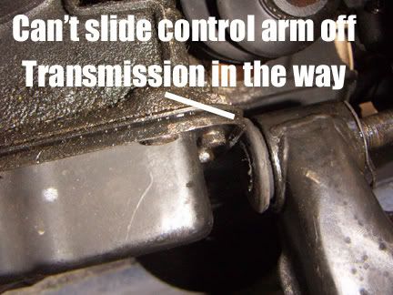

Left side control arm, everything loosend fairly easy. Except now I can't slide the control arm off due to the auto transmission is in the way (see the picture). Do I lift the transmission from the pan with a jack just enough so the arm can clear it? Need some advice...I'm so lame when it comes to auto repair.

That bracket that the control arm is on must be taken off.
Look at one of my post on broken bolt on control arm.
Unstake those two large bolts and take everything out at once. Pretty easy after that.
Fix any rust you find while your in there.

Thank you so much for the reply, yes I see them...they look like nuts...anyway, do I use a screwdriver to bend back the metal stakes?

Yes, just bend those back with a screwdriver. Also, I highly recommend that you heat all the bolts attaching the control arm before removing them. Use a propane or MAP torch. Rusty old bolts have a habit of breaking or becoming so stripped that you can't get them out, which is the case with one of the bolts holding on my control arm.
