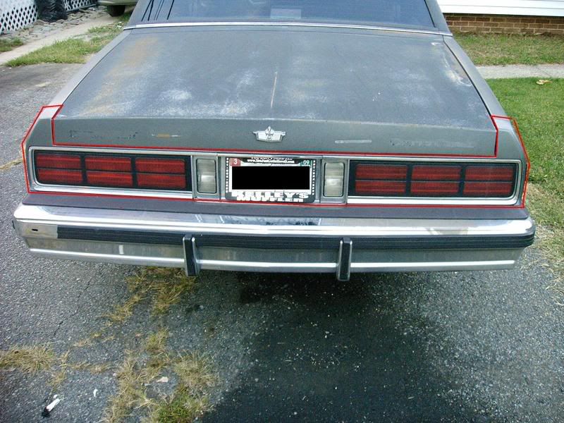

This whole piece is what you need. Simple enough to find at any junkyard.

thanks dude, that picture is what i needed to see. any other help would be greatly appreciated. Oh I was also wondering if the dome light is swappable. I have the single round one, and would like to install the other one with the center lens, and two side lights.

Here is another closeup of the one whole piece the dome light should be interchangable, i have the one with the two side lights, all the wiring should be the same.

so is that long piece underneith the tail lights a part of it too? the peice thats like a bumper filler? also would appreciate if anyone could help with dome light. thanks
Old 05-13-2008, 09:45 PM
mike561 mike561 is offline
Join Date: Jul 2005
Posts: 1,547
Re: early 80's to late 80's tailight conversion, and headlight cnversion
Yeah when i got mine the long piece was attached so it is part of it
