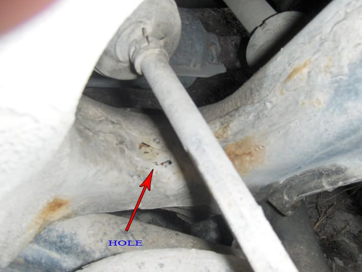

Mine is rusting and has already been sorta repaired by the previous owner. I will get the car on a lift and snap some good shots for you.
Here are some photos posted from TeamSwift.................

Holy Crapola!
Were those cars dumped into the Ocean and left for a year?!
They looked like they'd been dumped into ACID!
I've never seen such rust!
Now (7:40 PM) I'll go outside and have a good look at my '93 Metro for such
rust - in the morning!
Now I understand why you can't just weld some metal over them to fix this stuff.

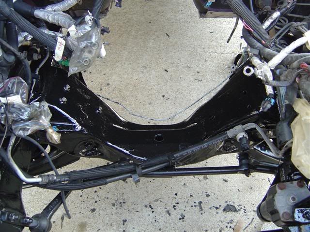

Yep! One word for those who have rust on the underbody of there metros, and plan on keeping them........POR-15 Treatment.
POR-15 Website
Use it per directions and it will never rust thru! My 1995 Chevy Caprice got the full "POR-15" Treatment on the frame a few years ago when I was doing a complete makeover on it, and I dont live in the "Rust Belt either!. Here's a few pics of what POR-15 Looks like when applied to a frame.

Did you bother to read the POR-15 Website before responding? That's exactly what POR-15 was designed for: to STOP rust and seal out and protect all moisture and outside elements (Salt) from collecting on metal surfaces and corroding it. BTW, our 94 Chevy 1500 trucks frame / underbody had also gotten the POR-15 Treatment on it 5 years ago, and we make an average of 6 trips to Mich and PA in the Winter time every year in it, and drive in the road salt for days at a time........It's still spotless!

GM: I've given you kudos before on your POR-15 job. I just can't help it man... It looks so good, my Caprice and I are jealous.

Thank you Matt......You know the B-Bodys are a labor of love, mine was no exception. Its a "Garage Queen" now and sits next to the Wifes 93 Roadmaster....68K Original miles on Her car....another garage queen. Here's a pic of the LT1 in my 95 Caprice, right before we dropped it in.........Mike
