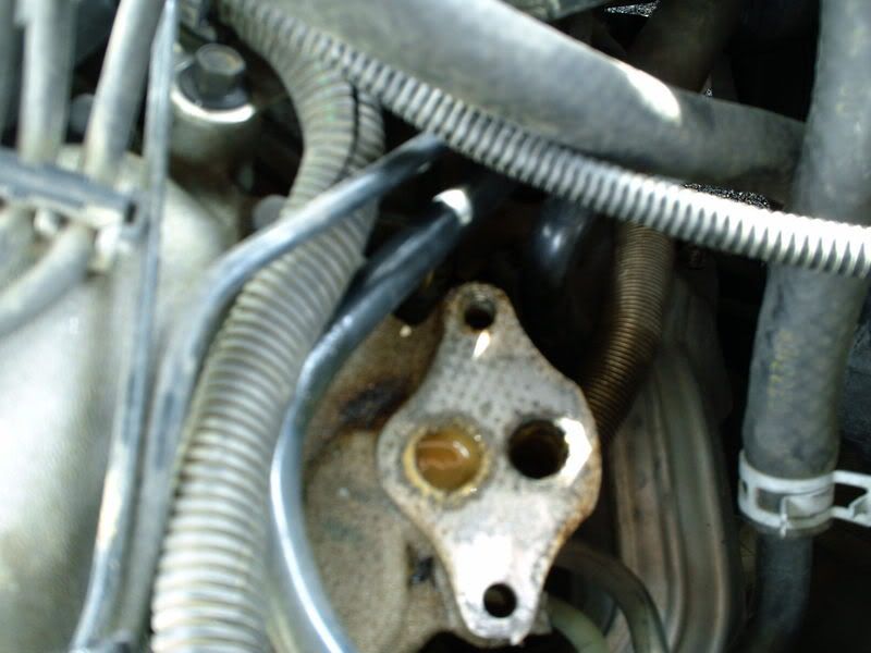

Here are photos of the EGR ports. The creamy yellow stuff is oily. I cleaned out as much as I could. Does that mean I have a blown intake manifold gasket? Will that just ruin a new EGR? Is there a way of testing if the EGR works? or do I just have to go buy a new one? Do you still think the O2 sensor is ok? Any thoughts or comments wlecome...

Well...the EGR hasn't been operating at all, or it would look the same on both passages...that being said, that stuff is obviously not normal....I don't know if it's coolant residue or just the result of condensation, intake vapors (fuel and oil) and rust...but the consistancy and color are sure similar to what you get when you have oil and coolant mixing...
This is really puzzling, but it's a good thing you had a look before doing anything else...
Does your car have the red extended life coolant in it, or the conventional green antifreeze?
The green stuff will poison o2 sensors if it makes it into the exhaust, is why I ask...the red will not, as far as I know...but I'd think it would ruin the pre-cat first...
I'll keep thinking...

Yeah, while I was cleaning it I pushed the valve down. It moves freely. I cleaned as much of the pool of yellow stuff out, put it back together, and jumped on the highway and it accelerated just fine. Went a couple miles and then slowed down and accelerated again, but it choked that time. I wondered if it was the fluid that was clogging things up. I don't know how quickly condensation and vapors can build that puddle back up. The fluid is in the exhaust tube too, So I guess the EGR isn't completely broken. It's got the green antifreeze. I checked the oil dipstick and it was normal, no chocolate mixture in it. I'll look and see if I can find a used EGR somewhere.

It would take months to build up that kind of mess...
This gets stranger...keep waiting for someone to chime in and say they've seen it before and set us straight...
Hot exhaust through the EGR circuit should blow/burn out any contamination like that if the valve functions...I wonder if the exhaust tube is blocked somewhere farther down?
because normally, exhaust is coming all the way up to the valve, so the exhaust side should be dry if it flows all the way to the source...
you try starting it for a moment with the valve off, see if it bellows exhaust out of the pipe side (i've done this, believe me you'll hear it if it flows...)? If it will run like this, you could also pop the throttle hard a couple of times and see if the valve reacts (leave it plugged in so it operates)...it should open wide when the throttle is stabbed suddenly...be careful...if it's blocked it may forcefully eject a wad of crap suddenly...make sure nothing in the path of the flow gets burned if you let it run like that for any length of time...

What I'm wondering is if the pipe got carboned up enough to reduce flow to the point where the condensation and crud could build in there...then when you cleaned it you might have gotten a partial flow, that pushed more crap up from the exhaust side into the ports...and now it's blocked again...
I dunno...this is weird...but I do think we're on the right track...
