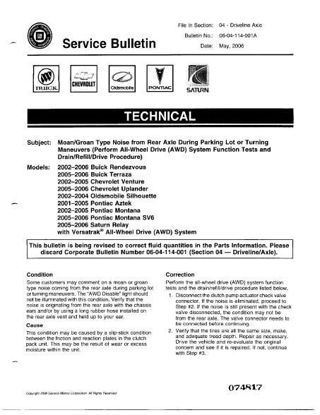

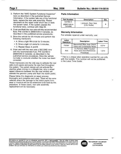

yeah there is a problem with those rear diffs being noisey. The local GM dealer should be able to help you out. There has been a couple service bulletins out there to fix it. Sometimes a fluid change fixes it, sometime a replacement diff fixes it.

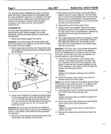

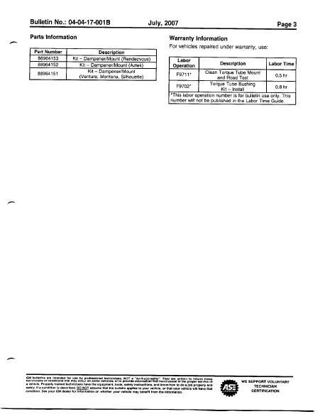

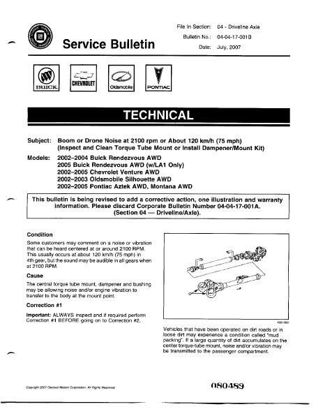

I have had the same problem on my '02 with 115,000 miles. It started after I had to have a rear tire replaced under warranty. The other rear tire was worn enough to cause a rotational difference between the tires. I was able to lessent the noise by rotating the tires, keeping the newer tire on the front.
It is ridiculous that GM expects all tires to be the same all the time. You aren't replacing all 4 tires for a sidewall cut on one of them at 20,000 miles. I have the GM bulletins as pdf files. PM me if you need a copy of one.
GM also has this bulletin on driveshaft noise. The service bulletin kit is about $500.
