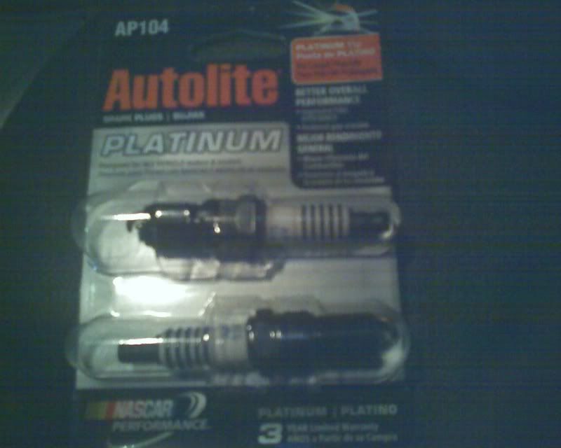

using Autolite 104 platinum plugs.
Thats what I thought. Then you are using the wrong spark plugs. Where you get your initial information or advice to use the colder range Autolite Platinums? The Autolite spark plugs referred on this and other GP forums are the copper core not the platinums. All advice related to mods such as supercharger is centered around using those only. For example I use the 103 not the AP103 or APP103 due to running a 3.0" SC pulley. The different type of Autolite plugs (i.e. - copper core, platinum, double platinum, xtreme performance) do not work the same and conduct differently due to material composition.
