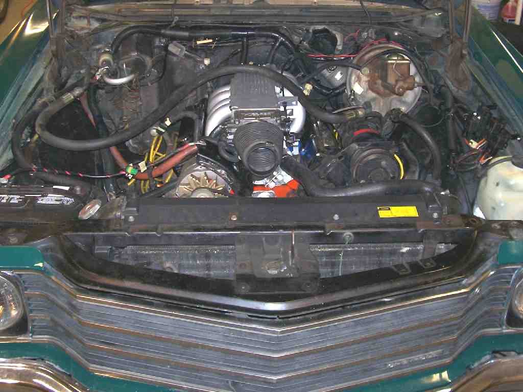

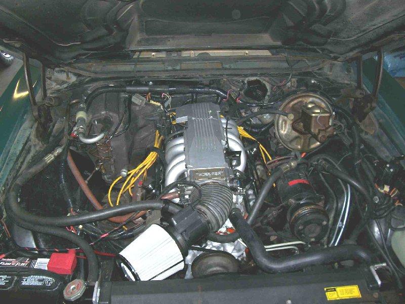

This is one I did, a '72 Chevelle, passing ther sniffer without a cat converter:
A TPI from an '86 will fit the older heads. Any EFI from '87-up will fit the older heads if the center bolt holes of the intake base are altered, or you can install later (centerbolt) heads.

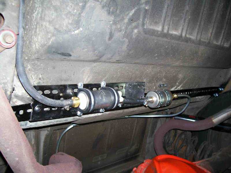

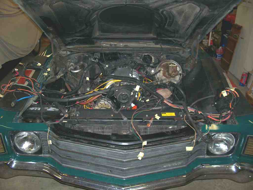

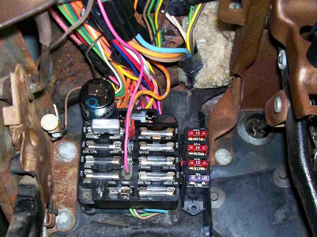

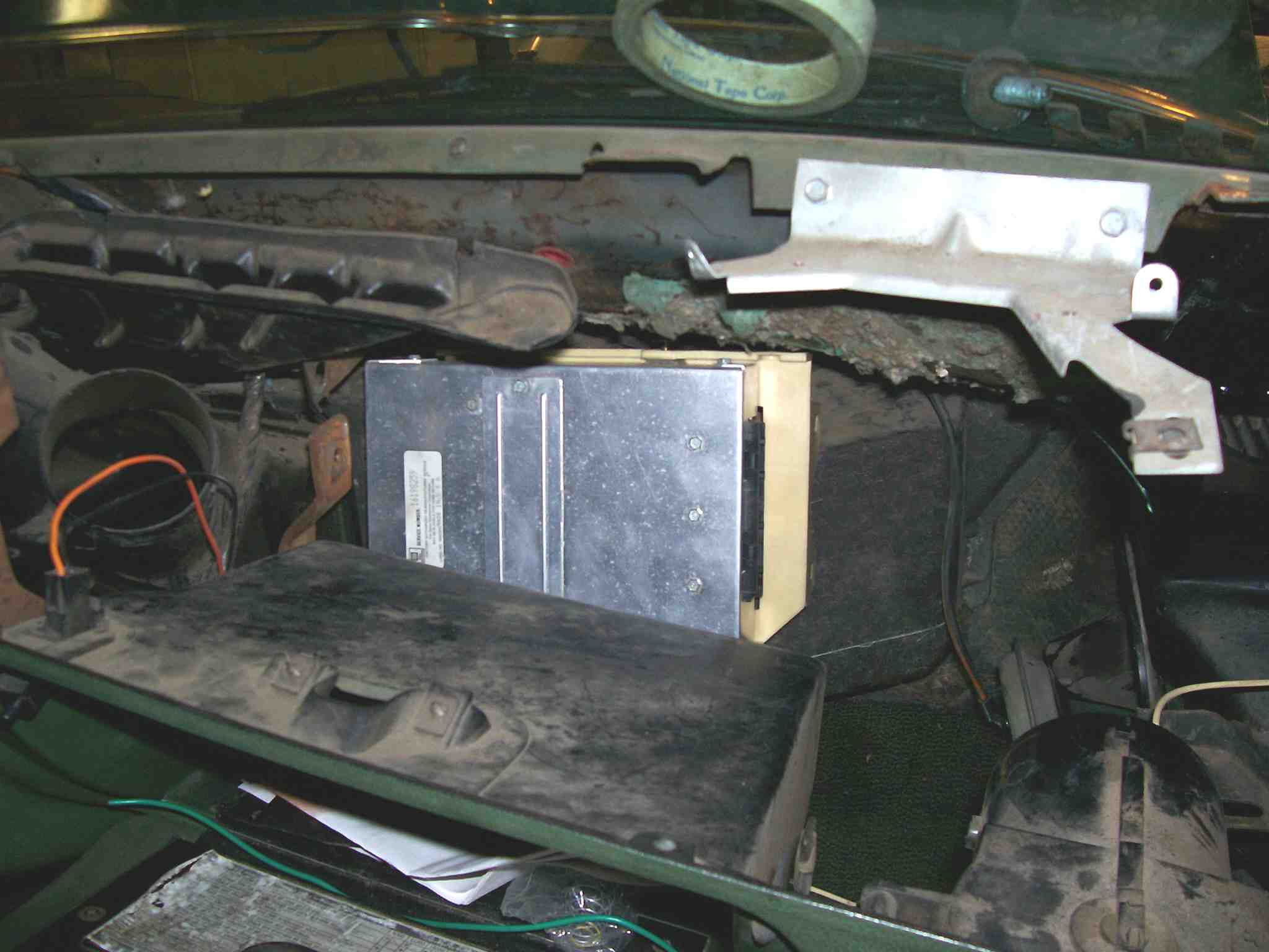

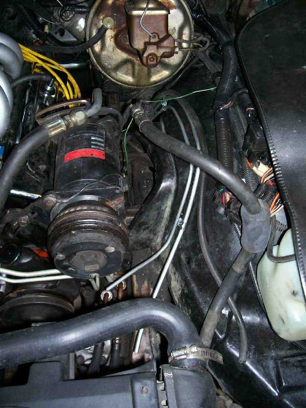

In case you're wondering, the complete TPI setup was from ebaY for about $350, including the harness, electric fan, relay panel, and ECM. The owner provided the TPI setup, new radiator, new water pump, and fuel pump, and the rest of the parts are outlined here:
I worked on it intermittently as it sat in my garage for 18 days. I billed it out at 33 hours labor, not including my reprogramming time after it had been running for several weeks to debug and tweak some parameters. If you do it yourself and shop wisely, you should be able to complete the job for right around $1,500, not counting your labor. Over $350 of the cost was in a replacement MAF, replacing some other parts not related to the TPI, a failed EGR temperature switch from the donor intake, and injector service. If you get a good MAF and other sensors (or use a speed/density TPI), decent injectors, and don't encounter other problems, you might save those expenses. This 350 is running on 19 pound injectors (from a 305) so they had to be flowing properly to be able to set up the pressure and constant to be able to map out the fuel correctly.
FWIW, it isn't super fast, but is much more fuel efficient, has loads of torque on the low end, in is consistent enough to have won it's class bracket for the entire 2007 season at Byron. Not too shabby for a 4200 pound slug.

Oddly enough, this was a CARB car. It was originally a California Emissions model from 1972, complete with EVAP. It can never pass a visual inspection in those states anal retentive/stupid enough (of which, there are many) requiring a visual inspection based upon the original configuration. However, it passes ANY state's emissions requirement on a treadmill, so in effect, it is way too clean to be a 1972 vehicle. It still has the EVAP (which is actually managed BETTER by the ECM than by the original vacuum / TVS configuration), and it runs on an active O², just like it should. For a 1979 model year vehicle, if you simply connect a pair of high flow 3-way catalytic converters and no respirator tube (or a single cat for single exhaust), and if you have any clue about programming, it will pass any 1979 model tailpipe emission standard in any state.

There's no need to send the ECM. All you need is a blank PROM and converted MEMCAL (or adaptor like Moates) and you can burn programs all day long:
